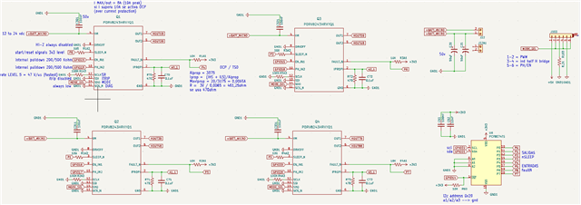

Hello Joshua, months ago I opened a thread "DRV8243H-Q1EVM: general configuration & layout revision".
I build some pcb boards according to schema provided in that thread. I'm testing them now but I'm facing some issues.
Looks like the IC is not receiving reset pulse correctly.
I'm using 4 pins of a pcf8574 to generate 3,3v SLEEP signals and 4 pins to read FAULTs.
During power on this sequence if followed:
- put pcf8574 sleep pin high,
- after 500 mili sec aprox execute the reset pulse (low)
- after 30 micro seconds put high again.
About i2c bus:
there is one ads1115
total pull up resistance 4,7K
Can pcf8574 cause problems?

  • Hi Juan,
    1. I'm having a bit of trouble following how the pcf8574 is connected to multiple DRV8243s. Can a block diagram be provided?
      1. also just to make sure, none of the DRV8243-Q1 are working correct, the nFAULT pin on all of them do not recover?
    2. Is it possible to probe the voltage at the VM pin as close to the pin as possible to make sure it is higher than the VM UVLO threshold?
    3. Can you measure the voltage on the IPROPI pin to check if it is 0 or closer to 5V? If it is closer to 5V this would indicate an OCP fault occurred
    4. Can you measure the current at the load with IN1 = High and IN2 = Low, this would also mean the fault is OCP?
    Joshua
  • Hello Joshua,
    1- below the relevant connections for pcf8574 and the four drv8243.
    For M1 corresponds P0, P4 (sleepPin, faultPin)
    For M2 (P1, P5)
    For M3 (P2, P6)
    For M4 (P3, P7)
    I tried same sequence with all DRV8243 and for none of them the FAULT pin gets HIGH after reset pulse (SLEEP pin 30 micro sec LOW).
    motor connected/disconnected is the same.
    should FAULT pin get HIGH after reset or not?
    2- it's not easy to measure at the DRV pin, but in that line I can confirm there are 12v. Just advice C301/302/303/304 are not soldered yet, C20/C21 ok.
    3- with motor connected to out1/out2 read voltage at IPROPI with an ADS1115 (Ax_1 in the schema), Rshunt = 470ohm, voltage is 0v.
    4- 30mA measured with a clamp meter, I think is in the order of the error...
    Best regards
    Juan

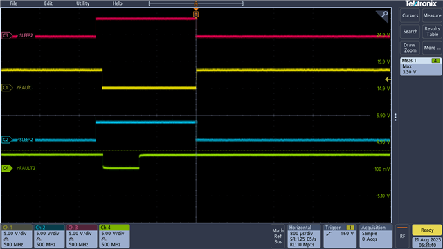

  • Hi Juan,
    Could you confirm if it's possible to provide the pulses to 4 DRV simultaneously from one IC pin?
    This is possible and will work. I was able to test this on bench with 4 hardware EVMs and only one MCU controlling the nSLEEP pin of all the DRV824x-Q1 Devices. In the capture below the top two lines are from one EVM and the bottom two are from another connected EVM.
    One more, could you suggest some 8 bit io expander up to 1,7MHz with same footprint than PCF8574?
    I recommend opening a related thread for this question. The reason that I say this is that a different group that support both the PCF8574 and similar devices will assign an engineer to the thread and they can recommend you the best part that would fit your application needs much better than I could.
    Joshua
