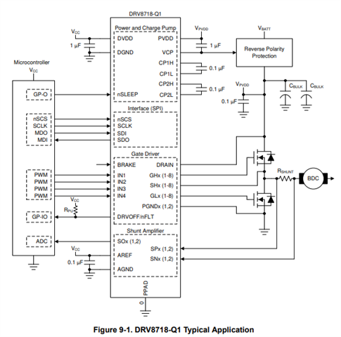

DRV8714 in half-bridge mode with no load connected. IC_CTRL1: 0x86, IC_CTRL2: 0x40. GH1 is turned on (BRG_CTRL1: 10b), but no output voltage is measured. A VDS fault occurs. After disabling the VDS check, no fault is reported, but still no voltage is measured. When a load is connected and IDRV_CTRL is set to maximum, the motor still does not run. What are other potential points to investigate? Thanks.​
