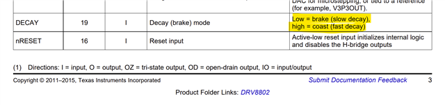

I understand that the Decay pin also has a built-in 10kΩ pull-down resistor, but the DRV8802 E2E forum lists both pull-up and pull-down resistors. Is this the same for the DRV8812?
DRV8802: DECAY pin

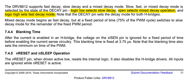

    The DECAY pin in the DRV8812 has three functions. See snippets from the datasheet. For DECAY 0 to 0.8 V SLOW decay, > 2 V FAST decay and around 1.4 V MIXED decay. When the pin is left floating, internal pull-up and pull-down would provide the voltage level for MIXED decay. I'd expect the values to be different compared to the DRV8802. Its ratio can be calculated by measuring the DECAY pin voltage when it is floating.

    The DRV8812 has the option for 3-decay modes. See below. Our recommendation is to either have the Decay pin LOW, HIGH or OPEN depending on the desired decay mode. For the DRV8812 internal Decay pin resistor values you can use the values referred in this E2E you highlighted.
    For the DRV8802 there are only two options for the Decay pin. See below.
    The above are the recommended connections for the Decay pin. Thank you.
