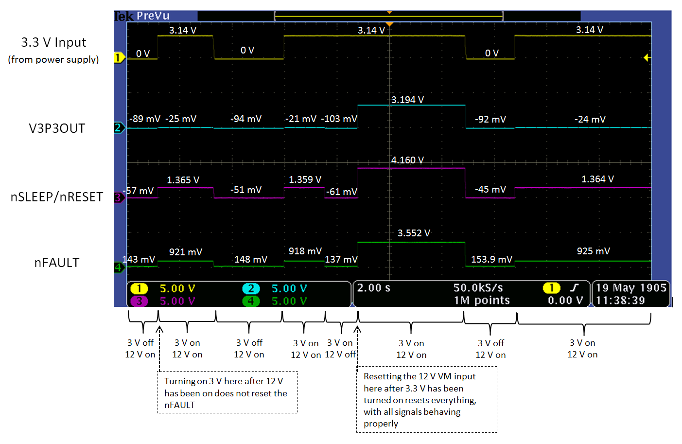

  • Here is a scope capture of the voltage levels, during different orders of power ups.
    The problem of  the lower voltage levels during a 12V then 3.3V power up has been narrowed down to I4, because when I4 is tied to ground, The voltage levels are the same (about 5.20 V) on nSleep and nReset regardless of the power up sequence.
    This problem has been looked into before in this post here  http://e2e.ti.com/support/applications/motor_drivers/f/38/t/259099.aspx
    But a solution was never found. I was wondering if any further insight could be gained, now that it is clear I4 is the problem source.

  • Hi Jonathan,
    Thanks for the additional information.
    If you power up only the 12V, what voltage do you see at I4? Even if current is flowing through all resistors I4 should not be lower than ~2.5V.
    Is it possible that the schematic and layout do not match, and the I4 layout trace is connected to an additional signal? I4 as a digital input should require approximately 100uA, and V3P3OUT can provide 1mA. It makes me think that I4 is much lower impedance than expected. That would explain damage to V3P3OUT when connecting I4 directly to V3P3OUT.
    Please check on the PCB that all grounds are connected (pins 14, 28, and the power pad).
    When you say that you are tying I4 to ground is there a jumper on the board to allow this? Are you cutting traces on the board to tie the pin to GND?
    If you find nothing can you provide the layout of the board, and the part numbers of the optoisolators?

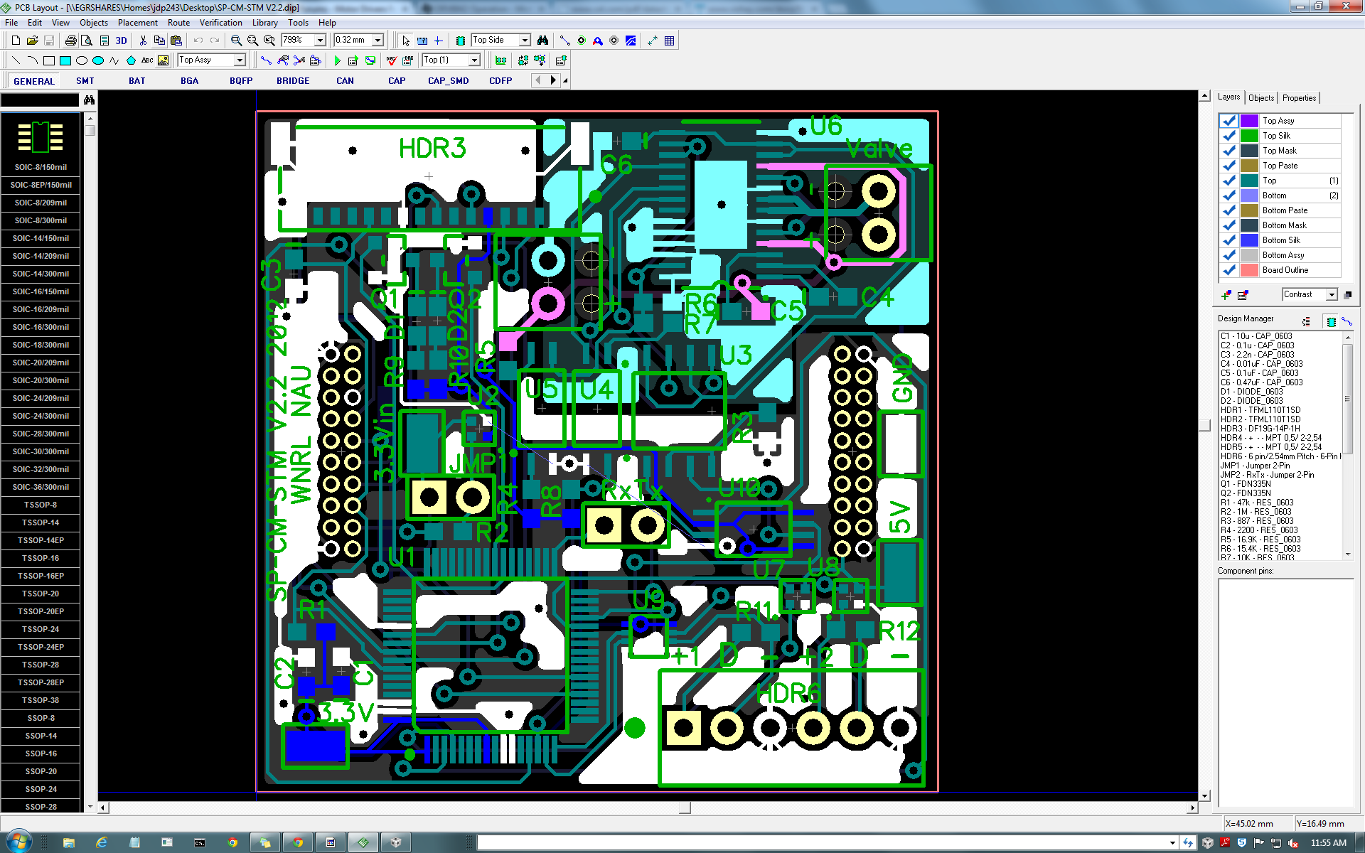

    I suppose it is possible that I4 is connected to an additional signal, although I'm not seeing that on the PCB or layout. Here is the layout of the board:
    2021.SP-CM-STM V2.2.zip
    When I am tying I4 to ground I'm simply lifting the pin from the pad, soldering a wire to it, and connecting the other end of the wire to ground.

  • Hi Jonathon,
    What layout program are you using? Is a free viewer available for it?
    A quick check makes me concerned about the connection to pins 16 and 17. The via under the device appears to be very close to the thermal pad. Is this correct? If so, it could short to ground.
    If so, can you cut the trace for pins 16 and 17 under the device, and the trace on the bottom of the board running to the via. Then check the voltage at pin I4 again. If  the voltage is good, connect pins 16, 17 using a wire from the via near R6,R7 and see if the part works as expected.
    I will continue looking at the layout once I obtain the viewer.  Thanks.
  • Hi Rick,
    Yes I can test that possibility. I will get back to you with the results.
    In the mean time the viewer for the layout program is called Diptrace and a free viewer for it is
    available here: http://diptrace.com/download.php
