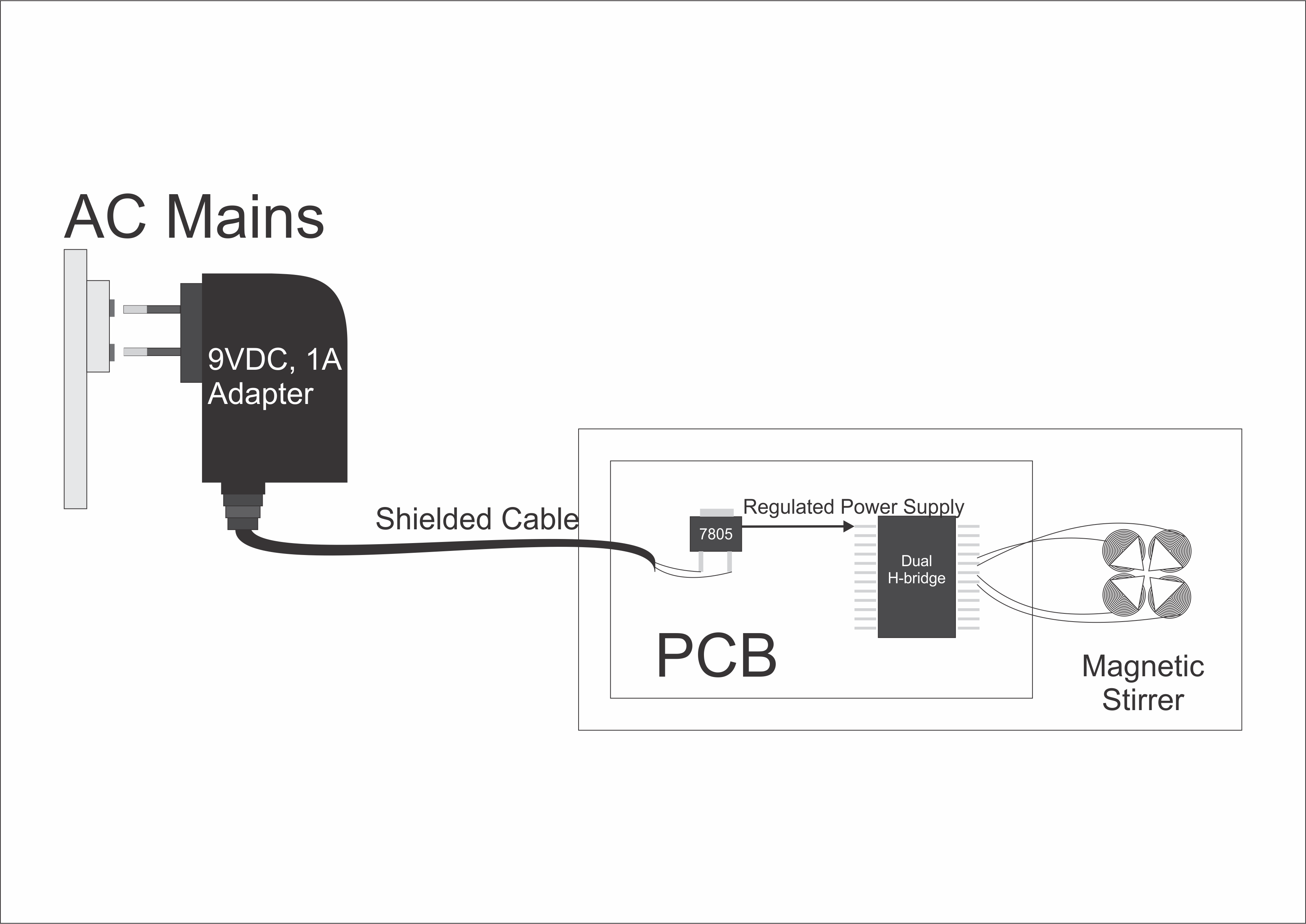

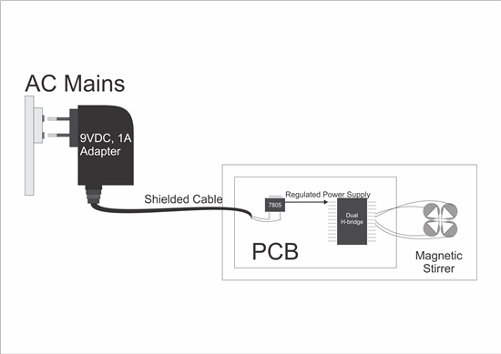

    Well in my project, its not a stepper motor. Instead its a combination of four coils, which we have made ourselves. Please find the attached block diagram.
    Hope it makes a sense. The product is called Magnetic Stirrer. There will be a magnetic bar rotating in the glass flask, placed at the top of the coil.Check this video fo0r reference. http://www.youtube.com/watch?v=r2EnpiKacw4
    Now I want more attraction for the coil, which can certainly be achieved by increasing current. But when I increase current, heating is an issue.
    Now I want to know if there is any issue with Electronics or if there is something wrong with Magnetics. Please find the attached schematic for review.6014.SCHEMATIC1 _ PAGE1-Magnetic Stirrer.pdf

  • Rahul, I reviewed the schematic and have 2 comments:
    1. The recommended value for C10 on VINT is a minimum of 2.2uF.
    2. It seems that R18 doesn't do anything, populated or not.  You might be better off making a voltage divider to VREFO, using a zero ohm for the top resistor and not-installed bottom resistor.
    For the heat problem, maybe the product's exterior could have some vents, and possibly also a low-profile fan like ones used in laptops.  A simple device for controlling brushed DC motors is the DRV8837.
