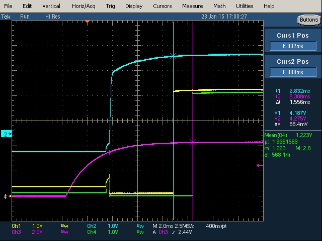

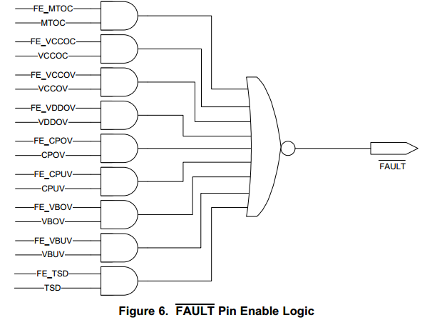

    The /RES line and the /Fault lines are independent of each other, and depend on different faults. If we look at the logic for the /FAULT signal (datasheet pg 12):
    And if we compare it to the logic for the /RES signal (datasheet pg. 6 & 7)
    From here you can see that the /FAULT pin does not have any dependency on VCCUV. Conversely, /RES does not have any dependency on several other signals including VBUV. This means that it is possible for the /RES signal to go high, while the /FAULT pin stays low. Here are three scope shots that show three different scenarios.
    For the below scope captures:
    Blue: VCC
    Yellow: /RES
    Green: /FAULT
    Purple: VB
    Scenario 1:
    VB ramps quickly to 5V, VBUV and all other faults are cleared and /FAULT goes high. VCCUV (and other signals not plotted) is cleared and after tON /RES comes up.
    Scenario 2:
    VB is set to ~4.3V, but on this device is lower than the threshold for VBUV, so /FAULT stays low. VCC comes up to its proper value so VCCUV is cleared and after tON /RES comes up. /FAULT stays low.
    Scenario 3:
    VB is set to ~4.3V, slightly above the threshold for VBUV, so /FAULT goes high, however VCC comes up before VBUV is cleared, so VCCUV is cleared and after tON /RES comes up. In this case /RES comes up before /FAULT. This is highly dependant on how fast VBUV is cleared based on the ramp rate. You can see that near the target VB ramps slowly, but VCC regulates to above VCCUV quickly.
    So for your question
    Q3: Please advise the duration time from fault flag is asserted to deasserted. To be clear, you want to know the time from when /RES goes high until all fault flags have cleared?
    It depends on your system. During power up, each flag  will clear when the associated fault is cleared. In the diagram you provided (NO.45_1), the fault flags may all be cleared already (t = 0), the fault flags may not be cleared but is highly dependent on your system (t > 0), or the fault flags may never clear as in Scenario 2 above (t=inf).
    Will Toth
