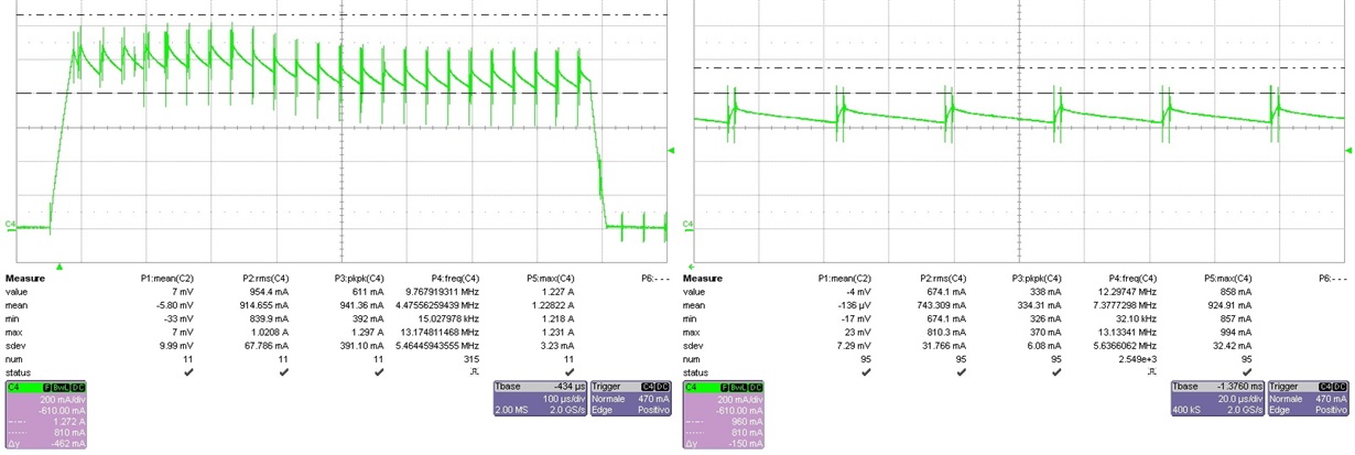

Hi all,
I am developing a new board equipped with two DRV8412.
Each DRV is configured in Dual full bridge mode with OC latching.
Power supply voltages are set with the following values:
PVDD = +24Vdc properly bypassed
GVDD = +12Vdc obtained from a linear regulator supplyed with the same +24Vdc that is connected to PVDD
and properly bypassed.
Each full bridge drives a 750uH inductive load (the full board drives 4 inductive loads).
The load current control is based on a standard chopping technique; PWM frequency is set to 31KHz.
About the PCB layout, it has been developed following the guidelines present on datasheet. Both DRV8412 and their
circuitry have been placed close to the output connectors.

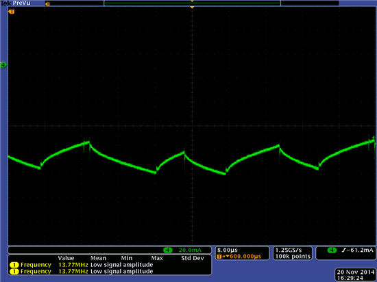

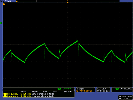

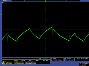

The problem I am seeing is that from bridge AB i get a clean current waveform; from bridge CD I get a "dirty" current waveform, as illustrated in the pictures attached. This happens on both the DRV8412 on the same board and on different boards.
Image1: current waveform obtained from bridge AB (on the left, the full waveform, on the right a detail).
Image2: current waveform obtained from bridge CD.
Can anyone suggest me where is the source of this behaviour and give me a suggestion on how to reduce or eliminate it?
Thanks a lot,
Sergio

    1) I have already tried to swap the loads but without any difference. The noisy current still come from bridge CD.
    I add some more details about the load I am trying to drive:
    the load is composed by an inductance about 330uH placed close to the board connector and it is connected by a 1.3m (1300millimeters) cable to the coil (that move a mechanical parts of the machine); the coil has a nominal inductance value about 420uH.
    2) about the layout, the two output channels (from bridge AB & CD) are quite similar, as you can see by the attached file.
    Here you find the schematic diagram about the first DRV8412. The second has the same schematic.
    DRV8412 power stage.pdf
    And here the power stage layout:
    DRW8412 power stage layout.pdf
    Sergio

  • Hi Rick,
    I have some more news to report.
    Yesterday I managed to obtain a board to test in laboratory, not on the field.
    I set up the board with the same loads, same cable, same power supply and same additional inductors (placed on a little PCB with the same connectrors of the DRV8412 Driver board).
    Sadly I have to report that on this board, the ringing current is swapped on the AB bridge, on both the DRV8412; to be clear where we have the "good" layout side, where the PCB traces run always on top layer.
    Following your questions, I got this results:
    Q2) output voltages
    On output connector I saw a square wave (from 0V to +24V) with an overshoot on the "corners" with a maximum amplitude amplitude around 2.2V (see the following picture).
    Observing the same voltage signal on the DRV8412 pin I see a reduced overshoot amplitude. I think the ferrite L10 is doing its duty.
    Moreover, this also means that the problem comes from outside to the DRV.
    Q3) enable one bridge per time
    I managed to activate one bridge separately from the other. What I see is that the activation of the second bridge increase the current ringing on the first.
    Q6) PCB traces
    I cut the connection on the bottom layet on the CD bridge and replaced it with a short pice of large diameter wire; I expected to see the DC bridge current getting whorse, similar to the AB bridge current.
    On the contrary, The current shapes on AB bridge (dirty) and CD bridge (clean) stay the same.

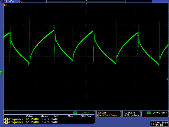

    After this I concentrated my attention on the cable harness. Here I summarize the results of multiple tests:
    1A) machine cable + external inductors (330uH) + AB channel on -> peak to peak current ripple on AB out = 260mA
    1B) machine cable + external inductors (330uH) + AB and DC channel on -> peak to peak current ripple on AB out = 340mA (as previously said)
    2A) short and separate wire cable + external ind (330uH) + AB channel on -> peak to peak current ripple on AB out = 80mA
    2B) short and separate wire cable + external ind (330uH) + AB and DC channel on -> peak to peak current ripple on AB out = 80mA
    3A) long and separate wire cable + external ind (330uH) + AB channel on -> peak to peak current ripple on AB out = 118mA
    3B) long and separate wire cable + external ind (330uH) + AB and DC channel on -> peak to peak current ripple on AB out = 124mA
    this means that the lenght increase the problem
    4A) long and grouped wire cable + external ind (330uH) + AB channel on -> peak to peak current ripple on AB out = 309mA
    4B) long and grouped wire cable + external ind (330uH) + AB and DC channel on -> peak to peak current ripple on AB out = 437mA
    (worst case)

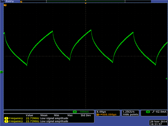

    5A) long and twisted wire cable + external ind (330uH) + AB channel on -> peak to peak current ripple on AB out = 118mA
    5B) long and twisted wire cable + external ind (330uH) + AB and DC channel on -> peak to peak current ripple on AB out = 118mA
    (best case)
    6A) long and twisted wire cable ( AB & CD wires grouped)  + external ind (330uH) + AB channel on -> peak to peak current ripple on AB out = 158mA
    6B) long and twisted wire cable ( AB & CD wires grouped) + external ind (330uH) + AB and DC channel on -> peak to peak current ripple on AB out = 189mA
    (intermediate case)
    7A) long and twisted wire cable ( AB & CD wires grouped)  + external ind (330uH) with inverted channels + AB channel on -> peak to peak current ripple on AB out = 77mA
    7B) long and twisted wire cable ( AB & CD wires grouped) + external ind (330uH) with inverted channels + AB and DC channel on -> peak to peak current ripple on AB out = 193mA
    (PROBLEM SWAPPED ON CD BRIDGE, like the boards on the field).
    I think we can conclude thath the cause is the harness.
    Let me know if you have some suggestions.
    Have a nice day,
    Sergio

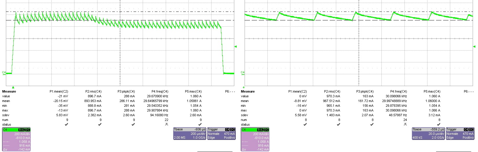

  • Here I report a table with the results of six measurement, all accomplished in the same way:
    - one channel (one full bridge) activated and the other three deactivated.
    - short and twisted cable (in this way I reduce the cable influence at minimum).
    - identical inductive load used on all channels.
    I have reset the board between a measure and the next.
