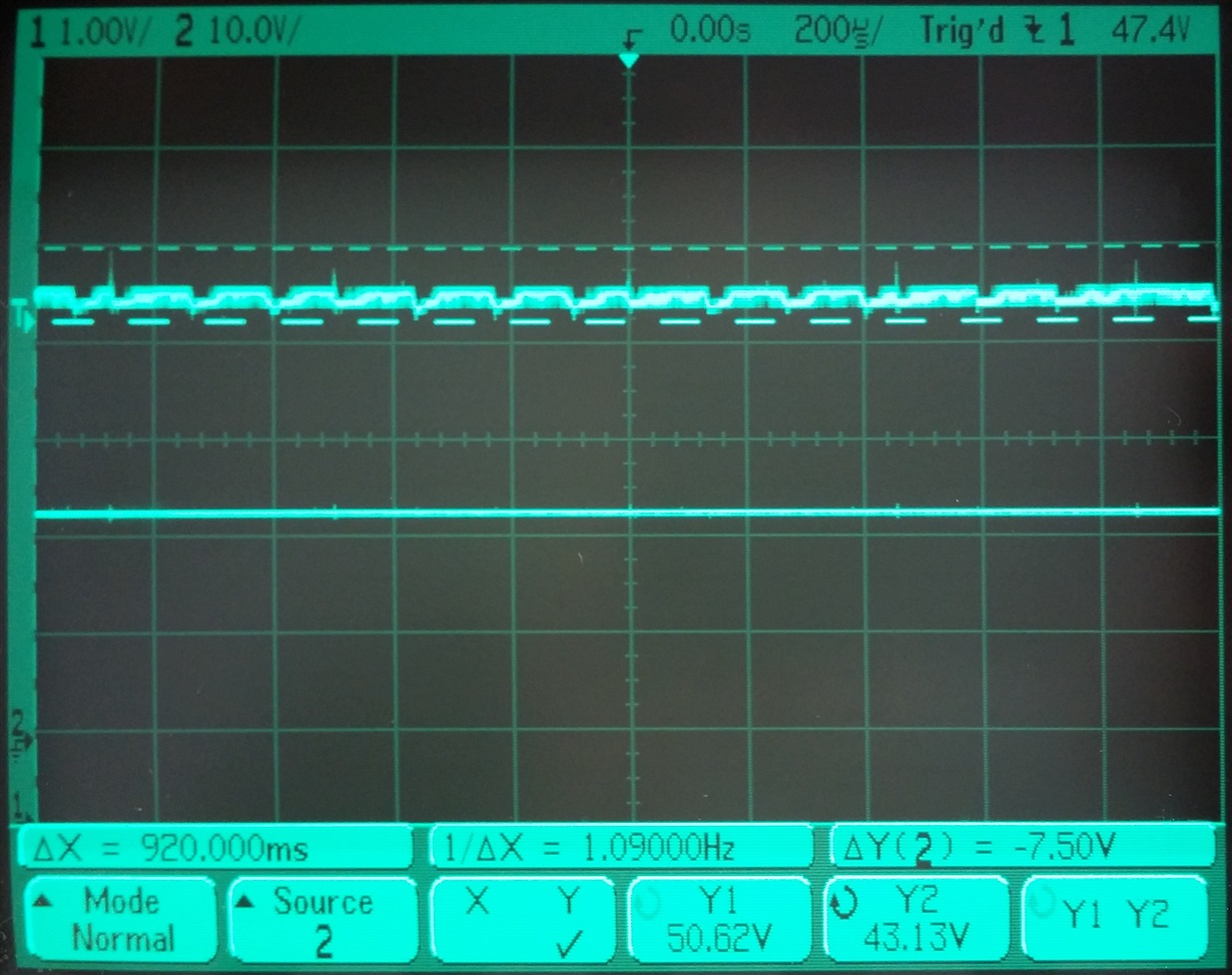

  • Find the scope captures attached, nothing special here
    Chanel 1 : 48V
    Chanel 2: 24V
    1. startup 48V
    2. Set Enable pin to 1, motor running
    3. Shut down
