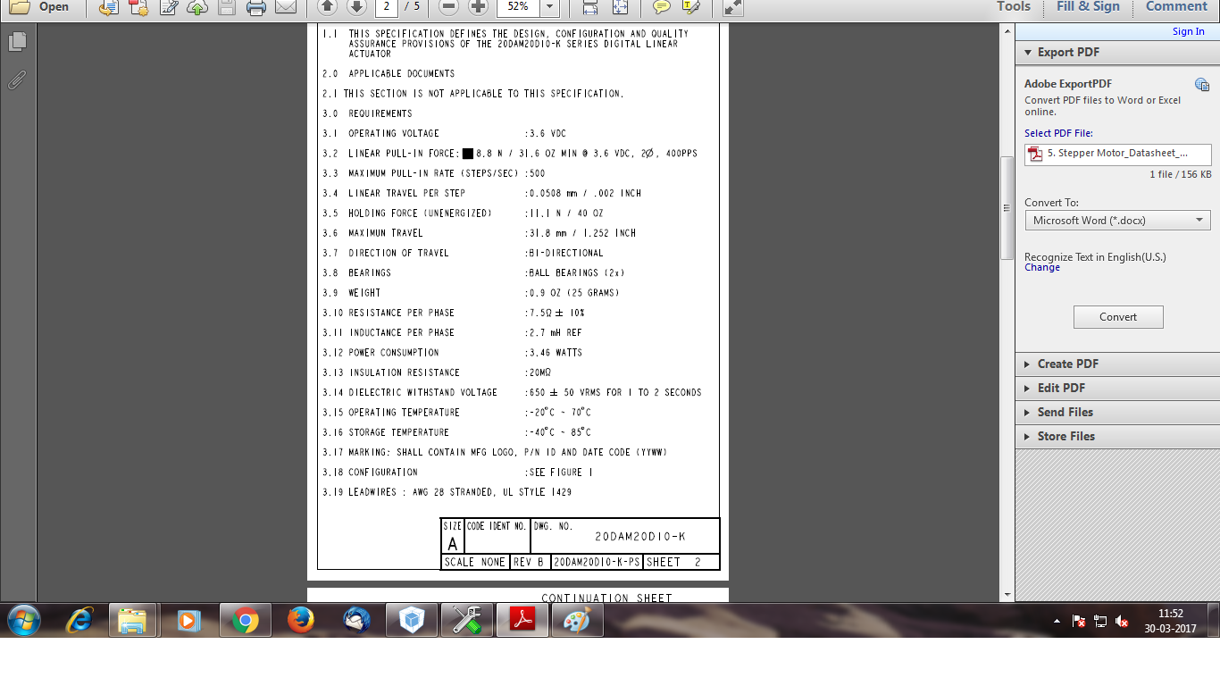

  • hello sir,
    thanks for your quick response.
    sir right now i dont have any sense resistor connected to my motor,
    and when my config pin is high,i have driver in mode32,config pin i have made high by giving 3.2v,
    i have attached screen shot of motor's specification.
    when  change motor's frequency i observed that motor i not moving and it is just vibrating on same position.
    i want to vary the speed of motor.
    please reply me.
    thanks
