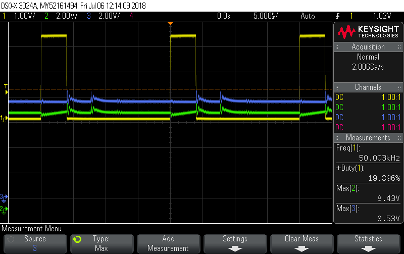

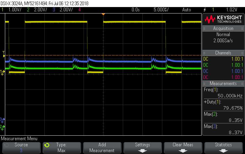

    Here is PWM_A (80%, yellow) and PWM_B (20%, green). Every signal is made with 3.3V logic.
    PWM_A (yellow) input and OUT_A(green)/B(blue) output:

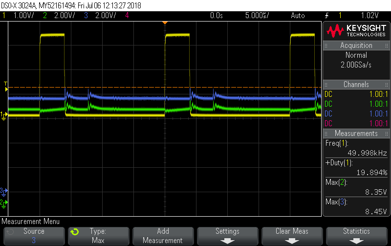

    PWM_B(yellow) input and OUT_C(green)/D(blue) output:
    Interestingly, I measuered PWM_B input and OUT_C/D output with no PVDD voltage and there was almost the same result as with PVDD voltage on:
  • Hi Tim,
    The scope captures show the device is not operating as expected. The reason is unclear.
    Please check the voltages at the BST_A/B/C/D and VREG capacitors. BST_A/B/C/D should be approximately 10V and VREG should be ~3.3V when VDD/GVDD_x is 12V and the PWM_A and PWM_B inputs are low.
    This will confirm the internal logic is awake and the connections at the VDD/GVDD_x pins are correct.
    Also please check the connections at the M3, M2, M1, RESET_A, and RESET_B pins in case there is a broken connection.
