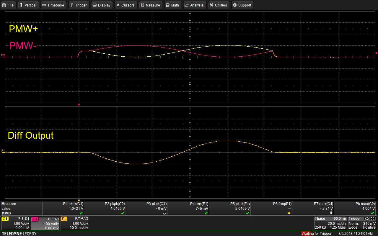

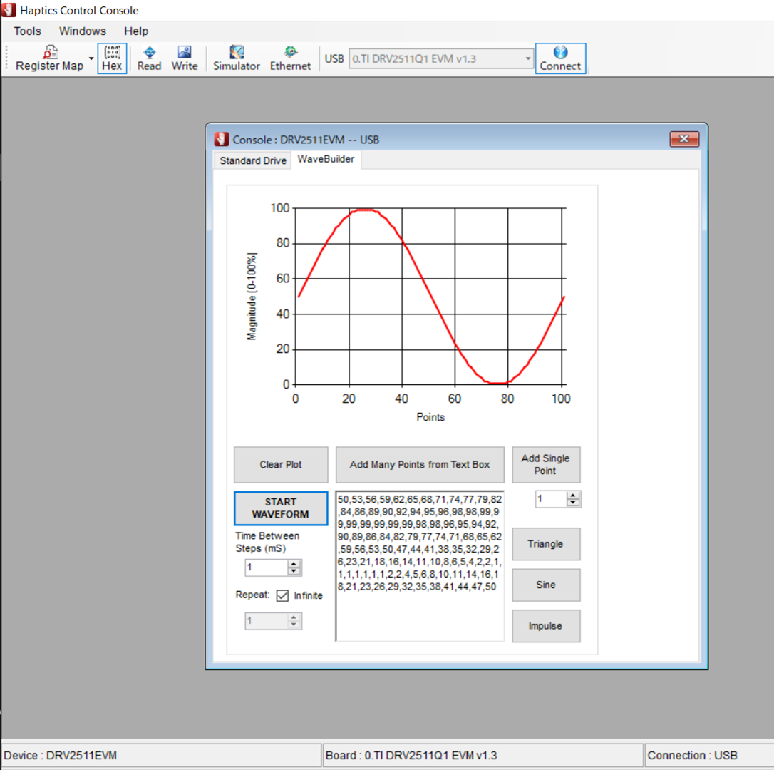

Hi team,
I want to use "Wave Builder" function of Haptics Control Console for DRV2511EVM.
But when I enable Wave Builder and push start button, the PWM+/- outputs common phase signal which result in differentially 0V on OUT+/-.
I could drive the solenoid by shorting IN- to GND for single end drive.
But is it possible to change the firmware to be able to drive differential signal on IN+/-?
