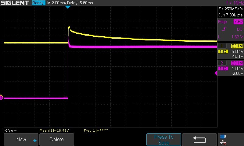

I'm struggling with debugging the charge pump on the 8305 on a custom board. My layout has been tested and works for a little while, but stops working after a few tests (Lab 2c bringup). The behavior after the fault is that the charge pump VCPH pin goes high and then decays as if it stopped running. Are there any debug tips to fix this particular behavior?

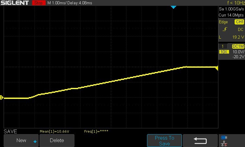

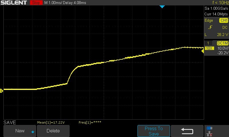

  • Adding more information on failure: I have scope snapshots comparing the Q1EVM board with the custom board. The Q1EVM has a distinct turn on point and goes to full Vb + 10v, while the custom board has a gradual slope and only goes to Vb.
    DRV8305-Q1EVM board trace for VCPH to GND
    Broken board trace from VCPH to GND
  • Hi Chad,
    That certainly suggests a damaged part to me. VCPH is the overdrive supply for the high-side FETs, so it should normally regulate to around VBAT + 10. Would you be willing to share your schematic, or at least the portions related to VCPH, CP1L/H, CP2L/H, and VCP_LSD?
