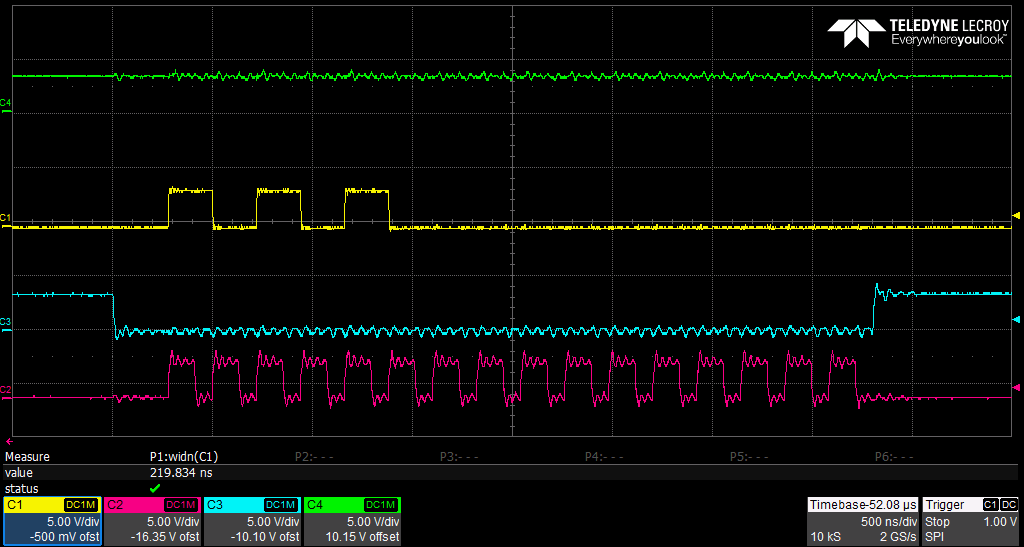

I am working with a SPI connection between the TMS320F28069 (master) and the DRV8323 (slave).
SPI sample rate: 4.5Mhz
nFAULT and SDO external pullup resistances: 4.7kHz.
ENABLE: 3.3V
Here is how i setup and use the SPI connection:

I'm using the below function to read from SPI
Uint16 DRV8323_readSpi(Uint8 regAdr)
    Uint16 controlword = 0x8000 | (regAdr & 0x7) << 11; //MSbit =1 for read, address is 3 bits (MSbit is always 0), data is 11 bits
    spi_xmit(controlword);
    Uint16 temp = spi_read();
    return temp;
In the main function i have tried calling DRV8323_readSpi(0x9800) and DRV8323_readSpi(0xA800) which should correspond with reading from "Gate Drive HS register" and "Driver Control register", respectively. However, both commands results in the SDO being purely high. It never returns any 0 at all. Scope pictures from the test (reading from "Driver Control register"):
Green: SDO
Yellow: SDI
Blue: nSCS
Pink: SCLK
It seems like i comply with the SPI timing requirements, stated in the DRV8323 datasheet. Can you please help me figure out the problem?
