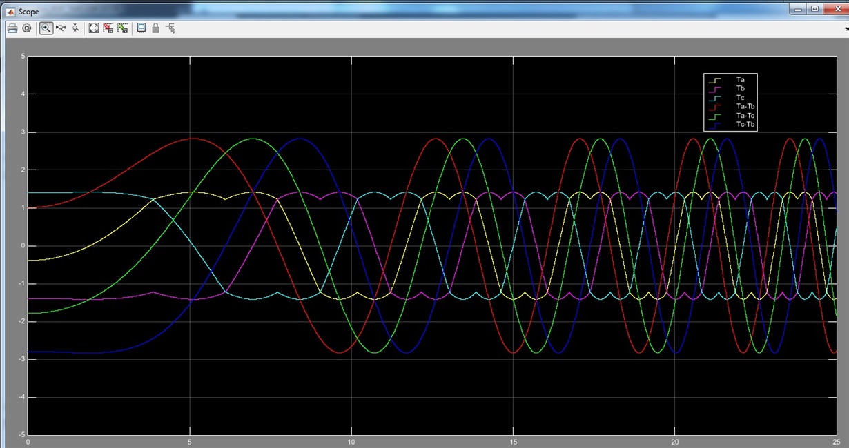

Hi Manoj,
thank you so much.
and i think it is related to how SVPWM method works more. Because i do not have problem to implement any simulation in matlab; just i think i do not know how SVPWM works.
for example if we can build PWM waveform from output of SVPWM blocks according to "Digital motor control" (below picture) so why Ta/Tb/Tc have minus values in half of their period? because they are time . how can they be minus ?

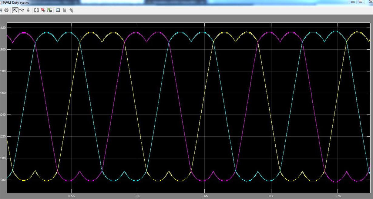

thank you for your answer, but as you see, there is a C28x PWM block
with no output to show 6 PWM wave forms in simulation environment.
If guide me to know how svpwm works (svpwm output picture from your
simulation file attached ) , i can simulate 6 PWM waveform anywhere.
i want to rebuild these 6 pwm in simulation, not monitor them from
real implementation.

i worked on SVPWM all a day and i have an advisement to everybody who want to understand this subject deeply
i simulate from generating 3-phase voltage to PWM Pulse and i checked all timing in scope.
