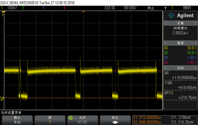

  • Hi Rick,
    First of all, thanks for your support. I’m a customer encountering the problem described in current issue.
    This issue occurs easier in closing gate which has been closed before. As expected, “Fault” pin should feedback to indicate end of close. But no feedback on “Fault” pin with lower voltage and 5.6ohm Rsense.
        As you required, some scope images are provided here.
    1.VCC:6.0v (Vbat), Rsense: 1ohm, IN1: High, IN2: Low, Out1: Yellow, Out2: Green, Load: Gate
    Voltage of output: 5*(100-44.273)/100 = 2.78V (Close to 2.5V )
    2. VCC:6.0v (Vbat), Rsense: 1ohm, IN1: High, IN2: Low, Out1: Yellow, Out2: Green, Load: NULL
    Voltage of output: 5.4*(100-52.340)/100 = 2.57V (Close to 2.5V )
    2.VCC:6.0v (Vbat), Rsense: 5.6ohm, IN1: High, IN2: Low, Out1: Yellow, Out2: Green, Load: Gate
    Voltage of output: 5.2*(100-81.44)/100 = 0.96V (deviate from 2.5V, unexpected)
    3. VCC:6.0v (Vbat), Rsense: 5.6ohm, IN1: High, IN2: Low, Out1: Yellow, Out2: Green, Load: NULL
    Voltage of output: 5.1*(100-49.21)/100 = 2.59V (Close to 2.5V)
    4. VCC:4.5v (Vbat), Rsense: 1ohm, IN1: High, IN2: Low, Out1: Yellow, Out2: Green, Load: Gate
    Voltage of output: 3*(100-8.69)/100 = 2.73V (Close to 2.5V)
    5. VCC:4.5v (Vbat), Rsense: 1ohm, IN1: High, IN2: Low, Out1: Yellow, Out2: Green, Load: NULL
    Voltage of output: 4*(100-34.52)/100 = 2.61V (Close to 2.5V)
    6. VCC:4.5v (Vbat), Rsense: 5.6ohm, IN1: High, IN2: Low, Out1: Yellow, Out2: Green, Load: Gate
    Voltage of output: 3.8*(100-75.44)/100 = 0.93V (deviate from 2.5V, unexpected)
    7. VCC:4.5v (Vbat), Rsense: 5.6ohm, IN1: High, IN2: Low, Out1: Yellow, Out2: Green, Load: NULL
    Voltage of output: 3.9*(100-34.02)/100 = 2.57V (Close to 2.5V)
    Summary: Voltage of output is unexpected as design with Rsense 5.6ohm and load of gate, regardless of Vcc.
    The following images show the process of closing gate, the fist image show that output wave(Vcc: 6.0v, Out1: Yellow, Out2: Green). The second image show the voltage of Rsense(Green) and feedback of “Fault” pin (Yellow).
    Because of limit, for now, we provide those scope images here. Look forward to your supports. Thanks.

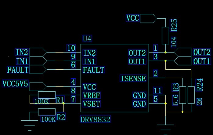

  • Hi Rick,
      The following diagram is a schematic related to DRV8832, please help correct the problem based on 70ma - 100ma current limit. Until now, the problem, that is, no feedback on Fault pin except for short low level during closing the closed gate with lower voltage, such as 4.0v(Vcc), still haunt us.
    The following wave capture of "Fault" pin show that  the period of low level is very short, less than 10us. And then no other feedback present in the subsequent phase.
    Looking forwart to your help, thanks a lots!!

  • Hi Qingfeng Yuan,
    Thank you for the additional information.
    If the sense resistor is too high, the PWM duty cycle can be limited. This may be occurring when using a 5.6Ohm resistor.
    If the sense resistor is too low, the stall detection may not operate. This may be occurring when using a 1Ohm resistor.
    The Risen resistor is primarily used to detect a stall condition. The DRV8832 limits the current during startup by slowly increasing the PWM duty cycle. The Risen resistor should be set to ~75 to 80% of the stall current. Setting the value this high will allow the motor to start, and will create enough voltage to detect a stall condition.
    Assuming a 25Ohm motor resistor and Vcc = 4V , stall current is 160mA. With a 20% variation of the comparator, it is recommended to set the Risen resistor to 2Ohms. Using 2Ohm will create up to 320mV when the motor is stalled. This is above the 240mV maximum trip point.
    A rough equation for selecting the Risen resistor is:
    Risen = 320mV/(VCCmin/(Rmotor_max + Rdson_HS_max + Rdson_LS_max))
    The 320mV is 80mV above the 240mV max trip point. This should provide enough margin to trip the comparator.

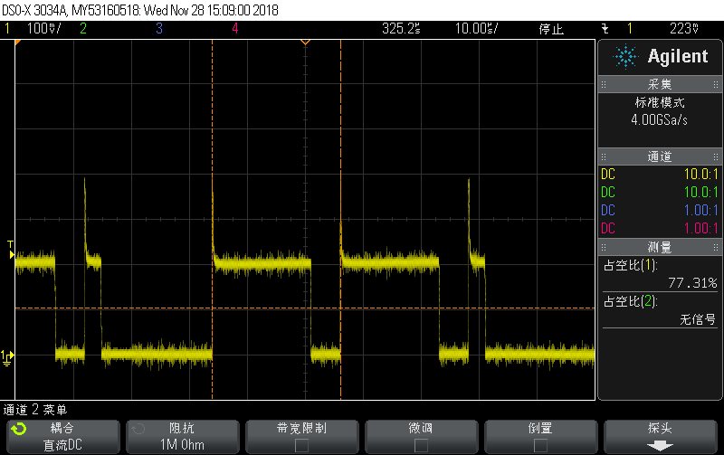

  • Hi Rich,
       According to your suggestion and theory you provided, Risens is adjusted to 2.2ohm. The voltage of Vout is expected as design: 2.6v, which is closing to 2.5v.  That's reasonable for now. But, no feedback on "Fault" pin still exists. The voltage of Risens is captured as follows:
    Even you has introduced  how to evaluate limit current, but there are some confusion because of wave of Risens's voltage, rather than a constant voltage. These wave doesn't trigger "Fault" event. What wave can trigger "Fault" event??
    Sorry for trouble again
    Qingfeng, Yuan
  • Hi Qingfeng, Yuan
    Is the scope capture provided during a stall condition?
    Assuming this is a stall condition, the voltage at the sense resistor is ~200mV. The current is ~90mA. The voltage is not enough to consistently trip the isense comparator.
    Please increase the sense resistor to 3 Ohms and try again. That should provide ~270mV at the sense pin.
    Below I have added a clarification to the stall detection:
    The stall detection operates by counting consecutive trips of the Ilimit comparator during a PWM cycle. There should be ~12288 consecutive trips of the Ilimit comparator (275ms/22.47us). If a trip does not occur during a PWM cycle, the count is reset to zero and begins again.
    In the image above you can see several times where the isense voltage remains at 200mV for more than 22.5us. This will reset the counter.

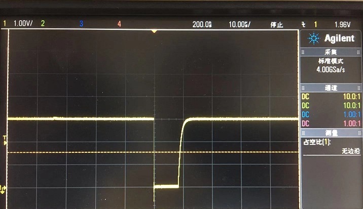

  • Hi Rich,
      After replacing with Risense of 3ohm, "Fault" report cannot be tirggered as expected yet. Monitor the voltage of Risense during a stall condition and capture the scope waveform as follows:
    It seems always 200mv or so, same as 2.2ohm. It's weird.  The problem happens to close the gate which has been in cloed state. When start to close gate, deduce from problem that DRV8832 want to increase PWM cycle to  the expected voltage of Vout, but because of current limit of Risense, stop increasing PWM cycle to meet 200mv on Risense, and limit Vout into 1.7v or so. If increasing the Risense to 3.6ohm, the volgate of Risense is almost simlar.
    Look forward to another feasible suggesion, thanks!
    Qingfeng, Yuan
  • Hi Qingfeng, Yuan
    The Vilim trip point on an single IC should be relatively constant. For the device you are testing, the Vilim trip point is approximately 200mV.
    Each time the voltage reaches ~200mV, the device will enter current regulation.
    Raising the sense resistor caused Vilim to be consistently triggered. When Vilim is consistently triggered, there is no need to increase the sense resistor for the device being tested. There may be a need to increase the resistor to account for the +/- 20% variation of the Vilim circuit.
    The scope capture shown should create a stall condition. It appears there is no drive pulse longer that the PWM period of ~22us.
    Please look for a Isense voltage pulse of >22us during the stall. Your scope should be able to trigger on the long pulse or record the longest frequency/pulse width. A pulse of >22us would reset the counter and prevent a stall from being detected.
  • Hi Rick,
       After several experiments with different values of Risense, the voltage of Risense during a stall condition is almost simlar, and the voltage of Vout decreases proportionally. Therefore, get the rule that DRV8832 is try to regulate current based on Vilimit during the starting phase.  This process is trying  its best  to start close or open operation and avoid mistrigger "Fault" report.
      Regarding the current problem, try to close the closed gate and always locate in the starting phase. Therefore, no "Fault" report during the real stall condition. Maybe lack of the process of "start, operation, stall", lack of the process of back-EMF, DRV8832 cannot detect the stall condition and always maintain current to keep Vilimit.
      Based on the deduction above, the driver of motor try to simulate the process of "start, operation, stall" and solve the problem for now.
      Could you detail something based on my deduction? Is it right??
      Thanks for your kind, patient supports!
    Qingfeng, Yuan
  • Hi Qingfeng, Yuan
    The stall detection circuit is probably resetting periodically, at least once within each 275ms count. I have seen this in the past, and there is typically no good method to fix this. You may be able to monitor measure the duty cycle, after a specified time using a timer/counter. There should be a difference between running and stall.
    There are other options, like the DRV8833C. This device cannot set the output duty cycle, but can be used to detect a stall. An example of how this would be done can be found here:
    During startup the device will regulate current. During normal operation, the device will provide 100% duty cycle so the motor voltage will be higher than 2.5V. As the motor stalls, the current will again be regulated. The outputs will begin PWM'ing and monitoring the outputs can detect this.
