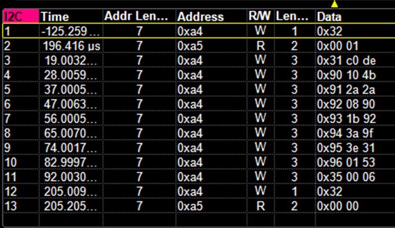

I am currently using DRV10983 for BLDC motor driving but my DRV isn't responding.
I am sending initially address twice but DRV is not acknowledging to my any of mine address and neither to the data.
Is the DRV damaged and thats why not responding or because i am sending my data twice and so it isn't responding?

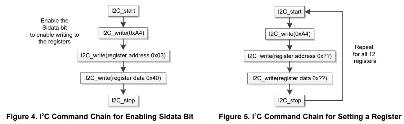

    Please use this guide for the proper format of communicating with the DRV10983 through I2C (www.ti.com/.../slvuaa5.pdf).
    In general, for the first 8 bit packet, the format is address "1010 010" and "0" for write or "1" for read. And then send the second 8bit packet as the actual data for write, or the register address for read.

  • Hey Sanmesh,
    I tried changing my slave address so i randomly send DRV address as 0x2A for writing and 0X2B for reading, it did acknowledge but it couldn't read nor could it write my data.
    If it is acknowledging it is not in sleep mode.
    And if i try to read i usually send START -> ADDR(WRITE) -> DATA -> REPSTART -> ADDR(READ) -> (wait for the data)
    But aft ADDR(READ) the clock is hold i mean to say that the data is not transmitted i.e cant see on oscilloscope and the read interrupt on my control has still not raised. So the data is not transmitted.
    If it is acknowledging then why is data not transmitted?
    And why is it acknowledging to random data and not to 0XA4 (slave write addr)?

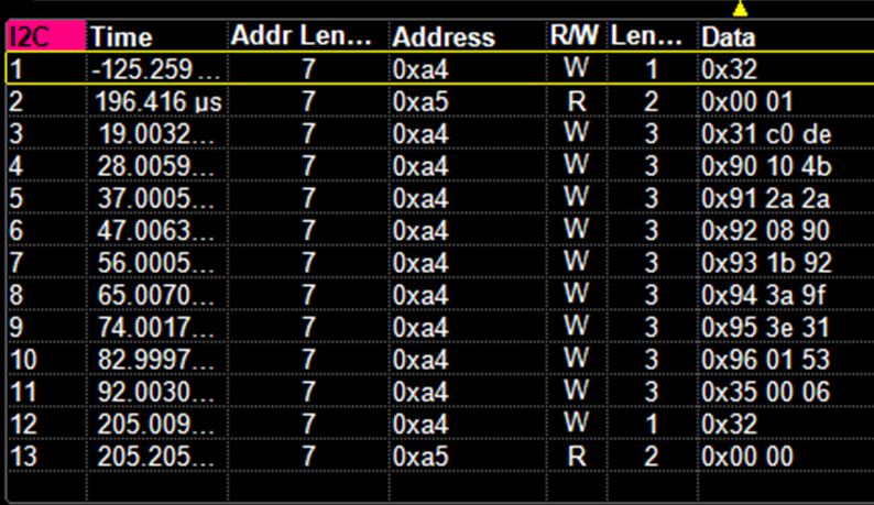

  • Hey jeet,
    From what I understand you are saying, you use 0x2A for writing and 0x2B for reading and getting some acknowledgement back instead of from 0xA4 and 0xA5. But you are not able to see any response to the read request. Let's be more specific.
    I want to be very clear on the I2C commands you sent and what you saw. Please either provide a list of the I2C data sent and read like the one below for the DRV10983-q1. One list should be the ones with the proper slave address of 0xA4 and 0xA5. The other list should be of the slave address of  0x2A and 0x2B.
    I would follow the commands in the "Programming Guide for the DRV10983". Please confirm you followed that exactly. You cannot do any writing to the registers till the Sidata bit is set to 1, and this is shown in the programming guide.
