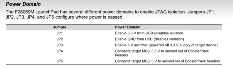

    The circuit I have shown is connected with the LAUNCHXL-F28069M. I supply 3.3V from the onboard dc-dc converter both to the DRV8305 Vref pin and to the MCU though the pin headers.
    On the MCU we intended to use 3.3V logic however by mistake the following jumper settings were used : (JP1 - JP5 : ON ) , JP6 : OFF. Furthermore, the LAUNCHXL was powered from a computer via USB simultaneously while my ciircuit was supplying it 3.3V from my onboard regulators.
    I believe this confirms the error> see attachment extracted from LAUNCHXL-F28069M datasheet.
    I am not 100% sure of exactly what would happen using the wrong jumper settings but I think it is possible that this has been the source of my issues. I am looking forward to putting in a new chip next week and trying it out.

  • Steven,
    Yes this is likely your issue. Please try the new IC and let us know.

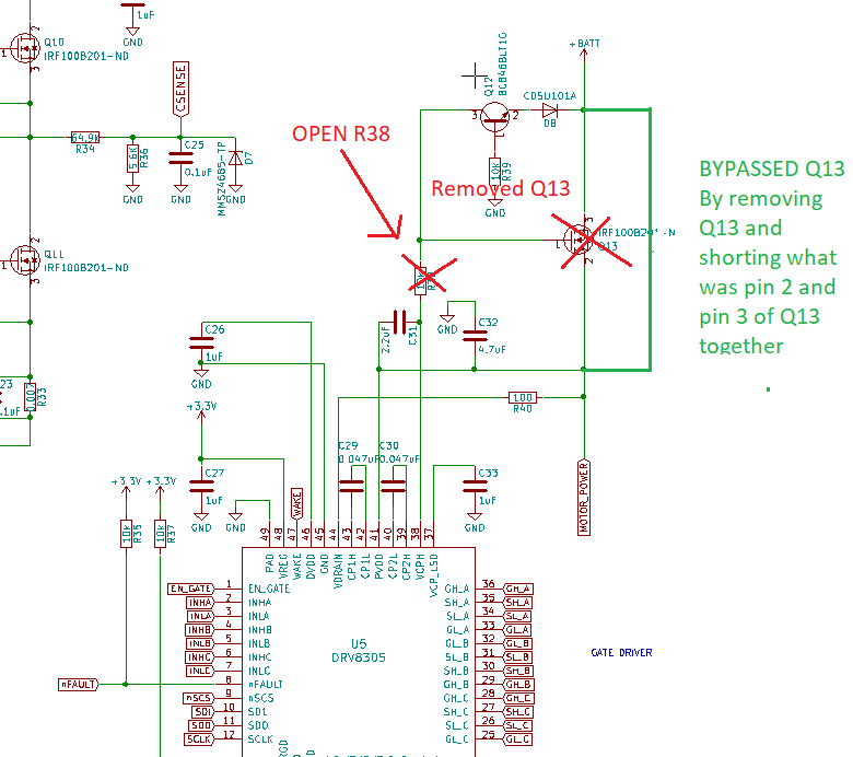

    Regarding Q13 you are right it is intended for reverse polarity protection. I've attached a screen shot of the DRV8305 guidelines for reverse polarity protection to this comment as well. I've been trying to understand what I've done wrong comparing the both of them but I don't see any differences. I've also attached some voltage readings that I was able to take off my board in a steady state with the board powered from a 36V supply and without running any code.
    My understanding is that Q13 is conducting under these conditions shown below.

  • Steven,
    I would start bypassing the reverse polarity protection and Q13 and check if normal operation can happen without overheating.
    -Adam
  • Hi Adam,
    Thanks again for your recommendations I truly appreciate the help.
    I've removed the reverse polarity protection scheme as in the image attached below. It still heats up super fast as soon as system enable turns on.
