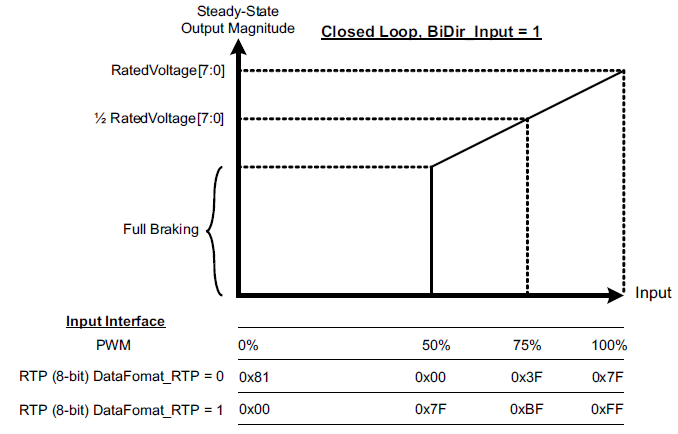

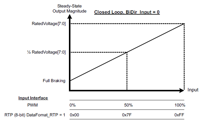

Dear,
About RTP Mode , if we send 0x00   1 time, PWM duty 50%  is always have? or just once?
between open loop and close loop different?
If any suggestion, Please advise me.
Lawrence.
  • Hi Lawrence,
    When you set the RTP PWM value it will be sent to the playback engine once it is triggered. The device will drive the same PWM signal unless you change RTP PWM value or stop the playback.
    They way that waveform is triggered depends on the trigger configuration, as shown in section 8.3.16.1 and 8.3.16.2 from data sheet: www.ti.com/.../drv2625.pdf
