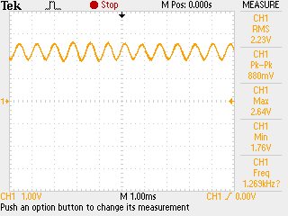

Picture 1: motor speed report may not exactly, it is far from the true. Over current is happened always at speed setting 280Hz. If increase speed setting to 300Hz, motor will shutdown automatically.

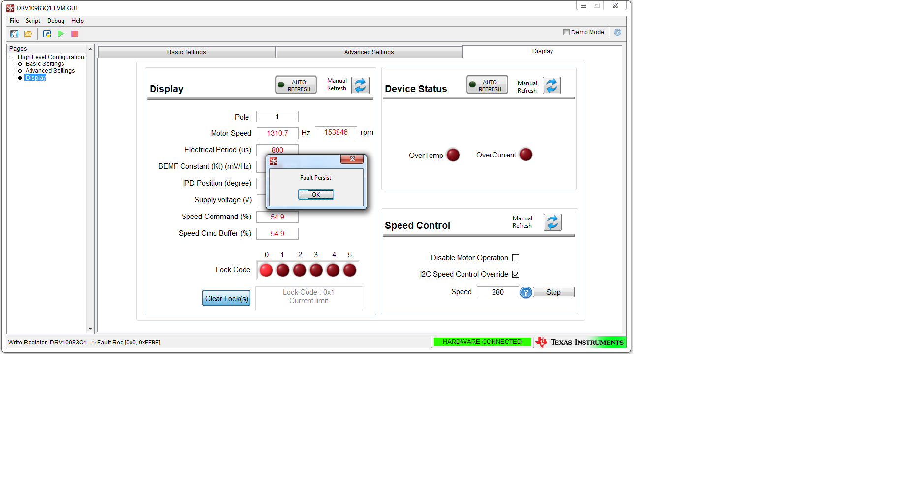

Picture 2: driver configuration

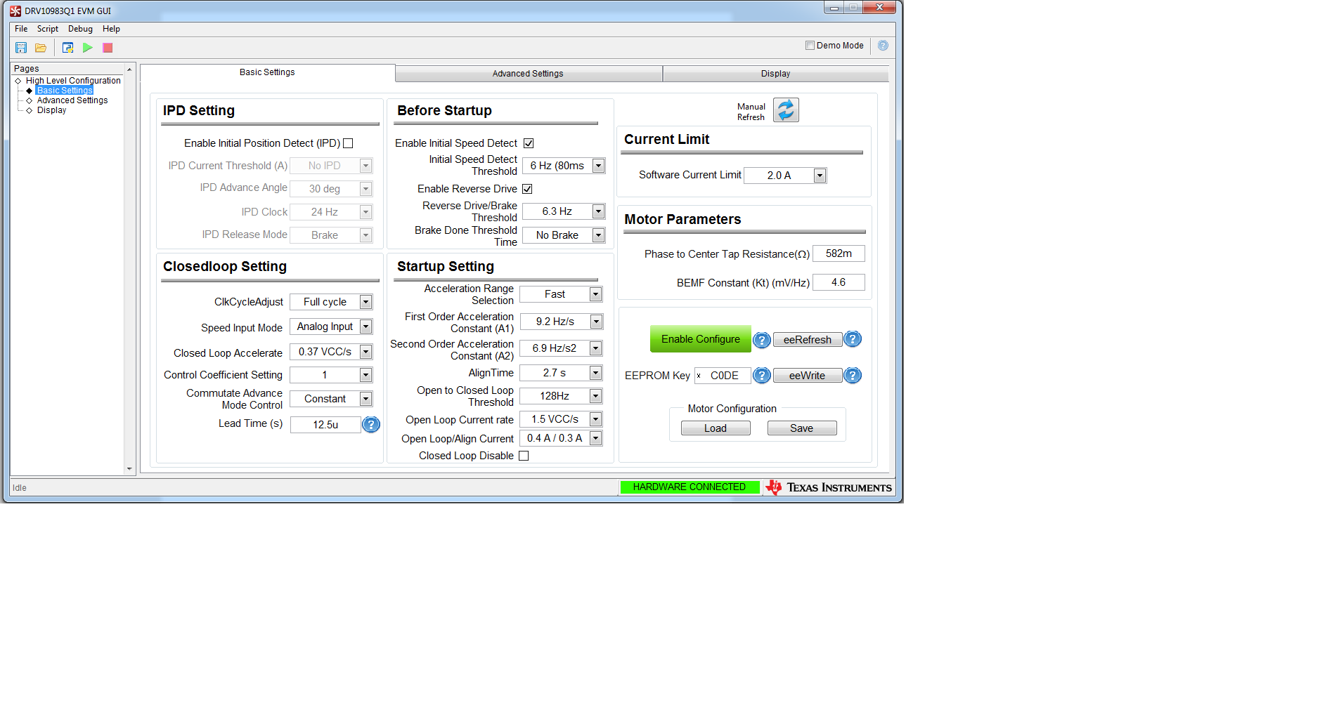

Picture 3: driver configuration

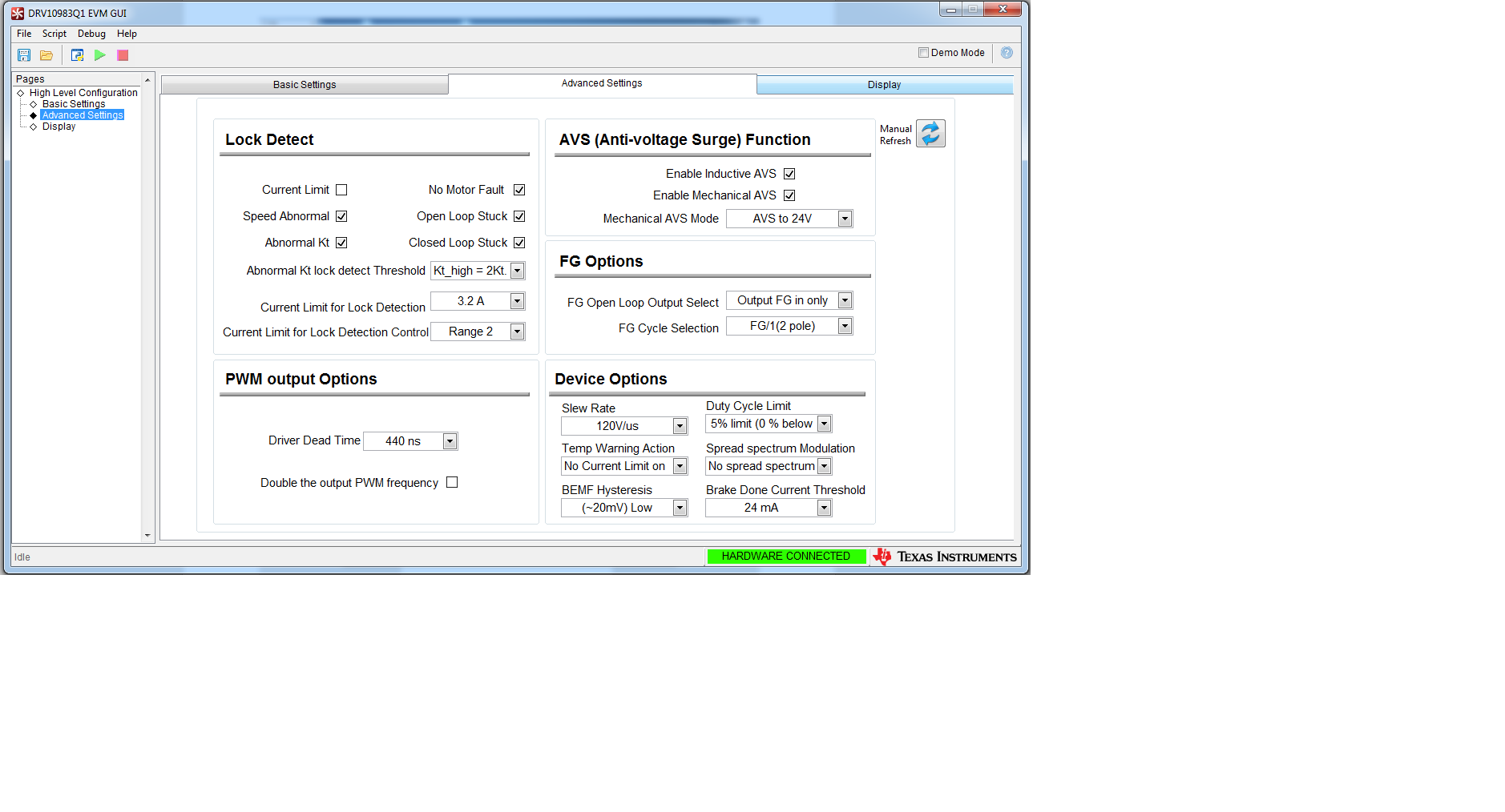

Picture 4: current waveform at phase V of the motor using current sensor ACS712ELC-05B. Voltage output 0à5V corresponding linearly with current input -5A à 5A (zero ampere mean 2.5V output).
From the wave form, we can see that the current is under 1A (the external digital monitor is also show that the average current is 0.8A). But the driver alarm Limit current even driver can run at 2A RMS, 3A max.
