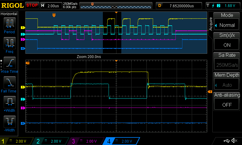

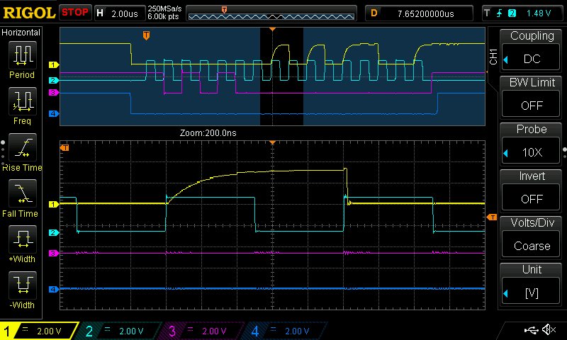

I have the same issue: the SDO singal is released by the DRV8323 too slowly. According datasheet max. 30ns, in our case about 600ns.
The SDO has an 4.7k Ohm pullup resistor to 3.3V. The 3.3V is stable, The SDO wire is about 4mm long on the PCB and nothing else is connected to it than the pullupresistor and a 6cm long wire wrap for the oscilloscope probe. I adon't think that the very little soldering flux on the PCB has an impact.
Any Idea why, the SDO is released so slowly?
Thank you and best regards
zoomed in:

    Yes, we tried different resistor values: It has an influence of the rising time (of course), but the cause of the problem is not fixed by just decreasing the resistor value. A value of 4.7k to 10k is common in such application. Anyway, the following screenshot is done with a 1.0kOhm pullup resistor, and we are still far away from the specified 30ns.

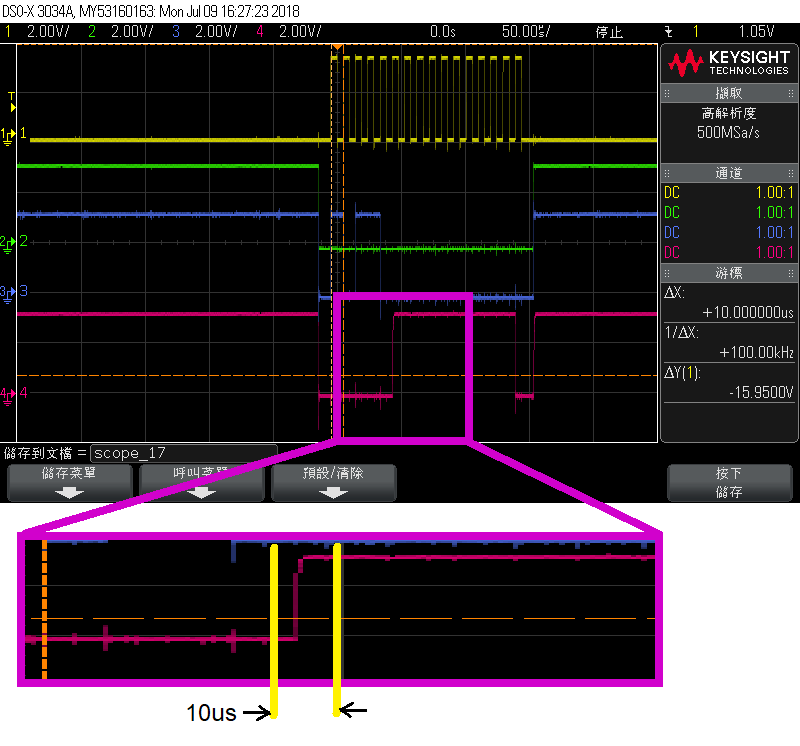

    I took the second last screenshot of the other thread (DRV8323: strange SPI output) and enlarged it as good as poosible, and you will see that in that case the same problem exists (it doesn't look like 30ns rising time at all):

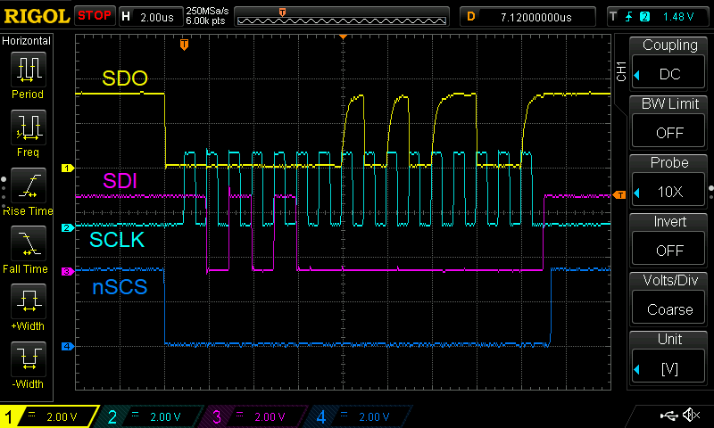

    On the SDO track there is an additional EEPROM (M95256-WDW) now, thus the DRV8323 and the EEPROM uses the same track on the PCB (total length: 64.1mm). The SDO track is pulled up with 4.7k Ohm to 3.3V. Thus, the EEPROM and the DRV8323 have the exact identical situation/setup. The rising time of the SDO signal is about 600ns, when the DRV8323 is active, and about 10ns when the EEPROM is active. Thus, the slow rising time iis not caused by the PCB or the like.
    In my opinion, the DRV8323 does not release the SDO fast enough. Probably, we have DRV8323s from a "not so good" lot with parasitic capacitance/inductance/resistance as you mentioned (on your eval board, there is an 10k Ohm pullup and you measure a 6x faster rising time). So this problem may not exist in the future anymore.
    Our work around now, is to use a normal speed (4MHz) to communicate with EEPROM (and later also a display), and a ultra slow speed (0.5MHz) with the DRV8323 for initialisation and fault read out.
