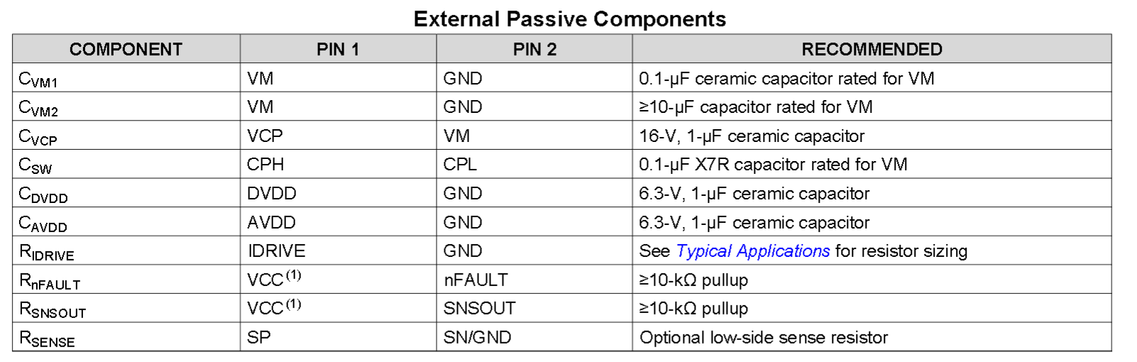

9. Does the application circuit have the required capacitor values and voltage ratings? Are the capacitors X7Rs?
With the exception of a cap bettween SP and GND which is C0G, all other caps are X7Rs. All cap values are as per the table below.

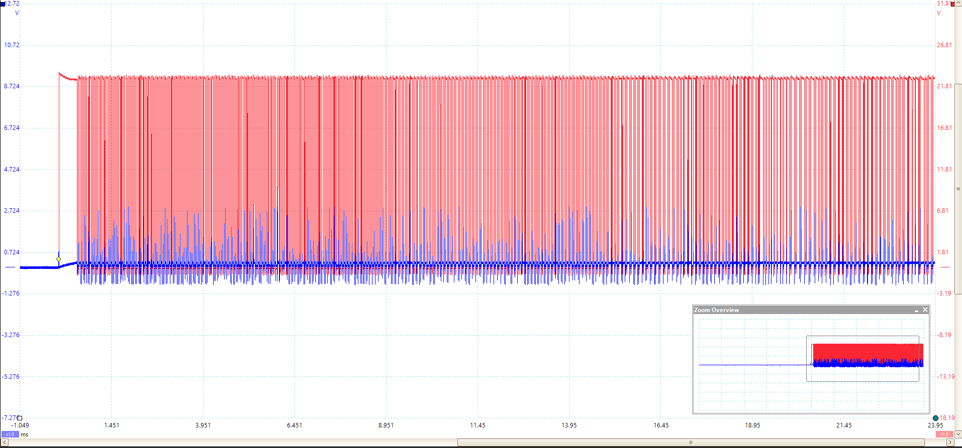

  • Hi Hector,

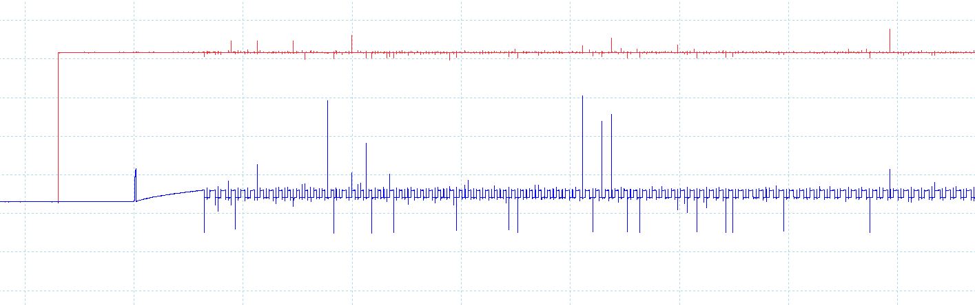

    Additional captures...
    GL1 Blue/GL2 Red full capture
    GL1 Blue/GL2 Red 1st zoom:
    GL1 Blue/GL2 Red 2nd zoom:
    GL1 Blue/GL2 Red No Load:
    GH1 Blue/ GH2 Red Start:
    GH1 Blue/ GH2 Red Zoom 1:
    GH1 Blue/ GH2 Red Zoom 2:
    GH1 Blue/GH2 Red Zoom 3:
    GH1 Blue/GH2 Red End Zoom:
    GH1/GH2 No Load: Looks similar on/off characteristic as GL1/GL2 No Load.
    SH1 Blue/SH2 Red Zoom 1
    SH1 Blue/SH2 Red Zoom 2
    SH1 Blue/SH2 Red End Zoom
    SH1 Blue/SH2 Red No Load:

    Thank you very much. I can see what you are zooming into on GH1 Blue/GH2 Red Zoom 3.
    There appears to be an amplitude jump in the signals between each period, as you have indicated.
    Right now, I wonder if the gate behavior you see comes from the digital PWM signal entering the driver.

    The concern I see is in the capture of End Zoom, such as GH1 Blue/GH2 Red End Zoom. When I look at the signals of the explictly stated capture, and compare them to, say, GH1 Blue/GH2 Red Zoom 3, I wonder if there is a difference between both of these capture states that we should be aware of? The end zoom capture has negative spikes on GH1 Blue and the toff time is not met, so I am not certain what is the setup or what is happening right now.
  • Hi Hector,
    I think those negative spikes are ringing due to current surges, and very low energy pulses (the compressor is pulling up to 18 A in it's current current-limited configuration). You can see them in both the "GH1 Blue/GH2 Red End Zoom" GH1 blue trace as well as the "GH1 Blue/GH2 Red Zoom 3" GH2 red trace.
    In terms of a difference, other than the alternating forward vs. reverse drive (as evident in the GH1 vs GH2 active signal), there is no different in the operating conditions of the two traces. Just different parts of a similar test run.
    But I think I see your point... it appears that near the end of the run, the device stops it's internal PWM behaviour. That brings the question of whether the current regulation PWM mode specified in the data sheet Section 7.3.3 is the same sort of PWM behaviour you would expect when operating with the DRV8701P device. It is interesting that it takes a bit of time at the beginning of each cycle before the PWM behaviour starts, as evident in "SH1 Blue/SH2 Red Zoom 2" and "GH1 Blue/ GH2 Red Zoom 2". Why is that?
    Looking at the frequency of operation in "GH1 Blue/GH2 Red Zoom 3", you can see two modes... if you look at the cycle time between a "large pulse" at 658us to the "small pulse" at 718us, you have a 16 kHz PWM, whereas from the "small pulse" at 718us to the next "large pulse" at 746us, it's closer to the design value of 35.7 kHz (f_pwm in the datasheet shows ~ 38 kHz). Is that because if the current limiter doesn't need to PWM, it will override and apply constant drive to the compressor?

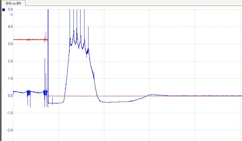

  • Hi Hector,
    I'm still hoping we can get some clarity on what's happening.

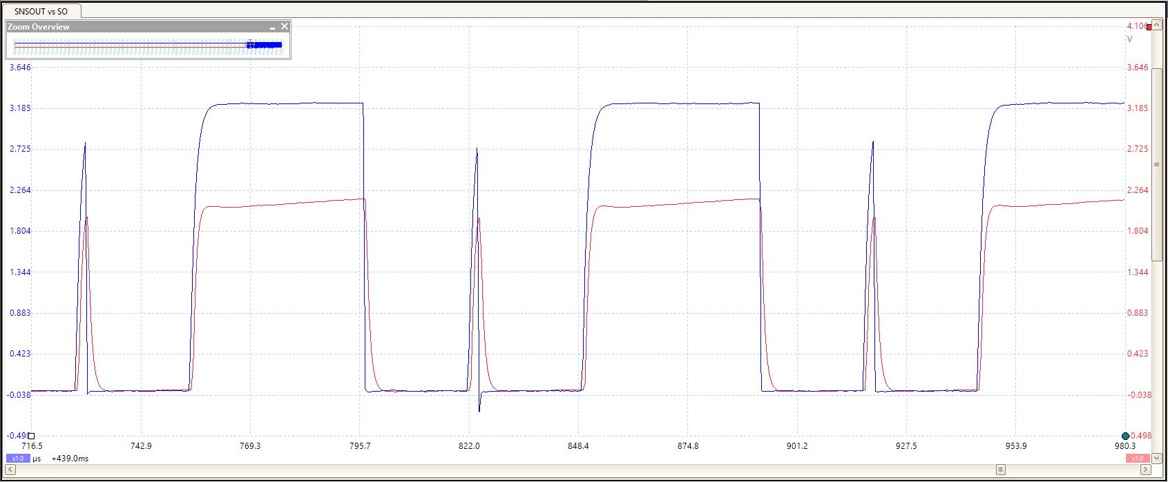

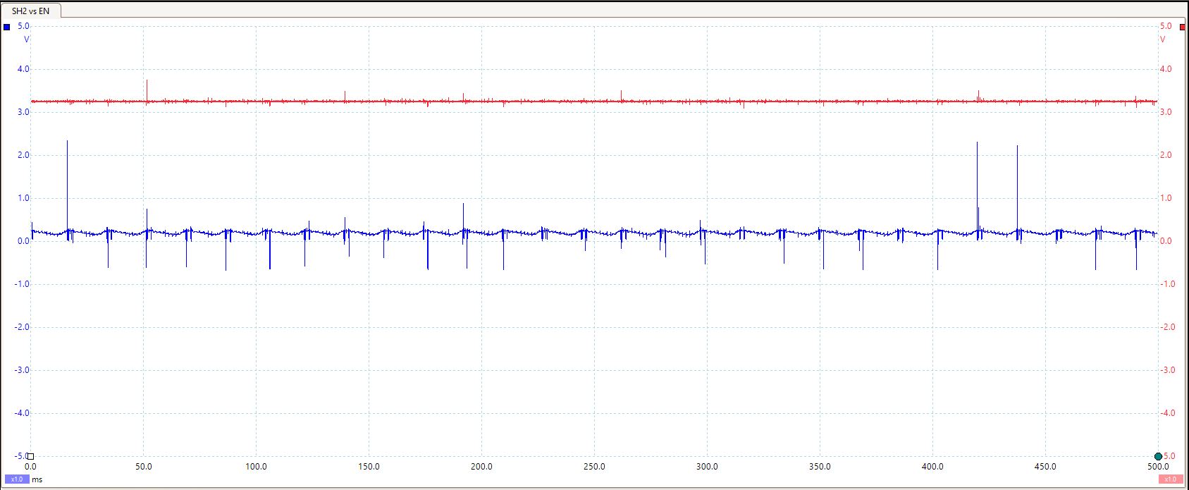

    Here are captures for SH and EN overlaid at the start, middle and end of a compressor cycle. We had filtering disabled to ensure we didn't hide something telling, so our probes are likely picking up switching and 60 Hz noise as well.
    In an effort to see if we could increase the size of the intermediate spike, we experimented with increasing the voltage reference (assuming that it was getting cut off because it went beyond the current surge threshold). Our threshold was originally set at 2.76 V for a surge of ~18 A. However it seemed that there was very little shift in the size of the intermediate spike even if we increased to 3.02 V. Also, the top of the pulse is much lower than the peak of the larger pulse on either side. We confirmed that there is no filtering on this scope capture of SO. (Vref  increased to 2.85V). We assumed that if we were hitting VREF with the intermediate spike, it would be obvious on the SO capture, but that doesn't appear to be the case.
    Any further ideas?
    Brad

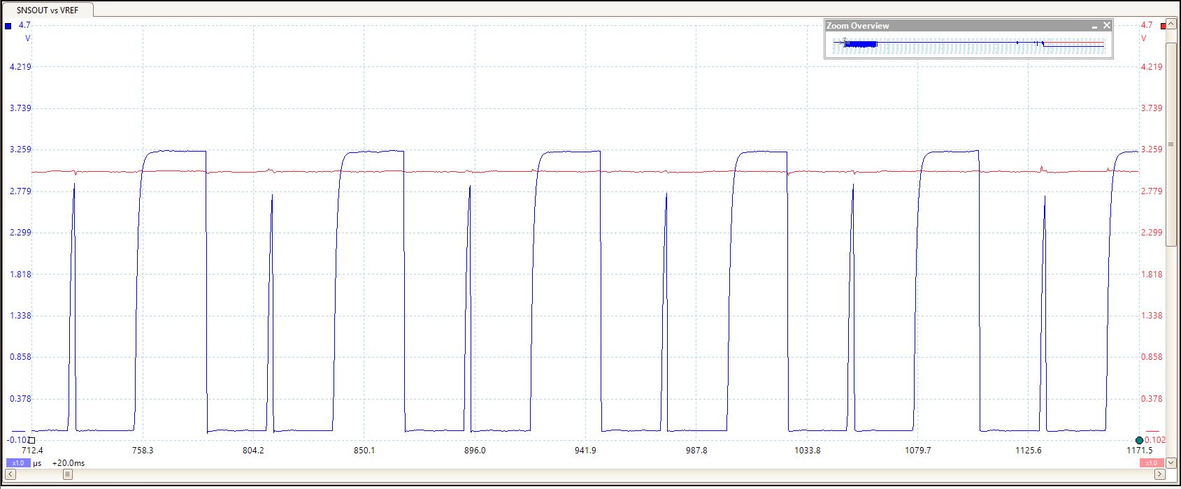

    I suppose it boils down to "Why is the h-bridge PWM pulse getting cut so short even though SO did not reach the threshold voltage?"
    Brad.

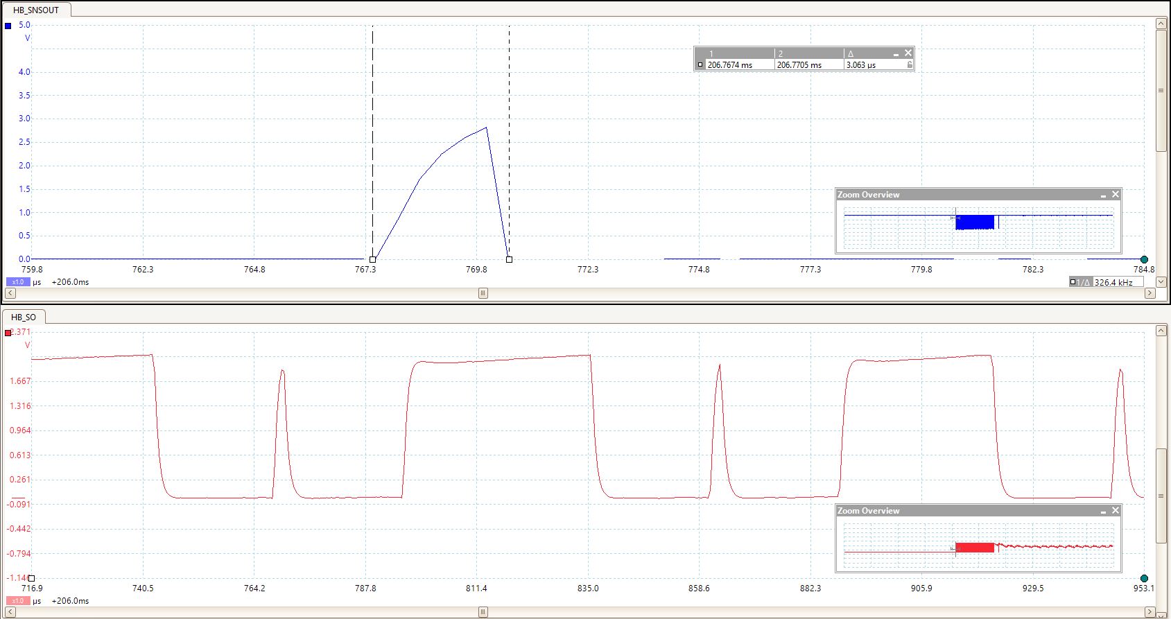

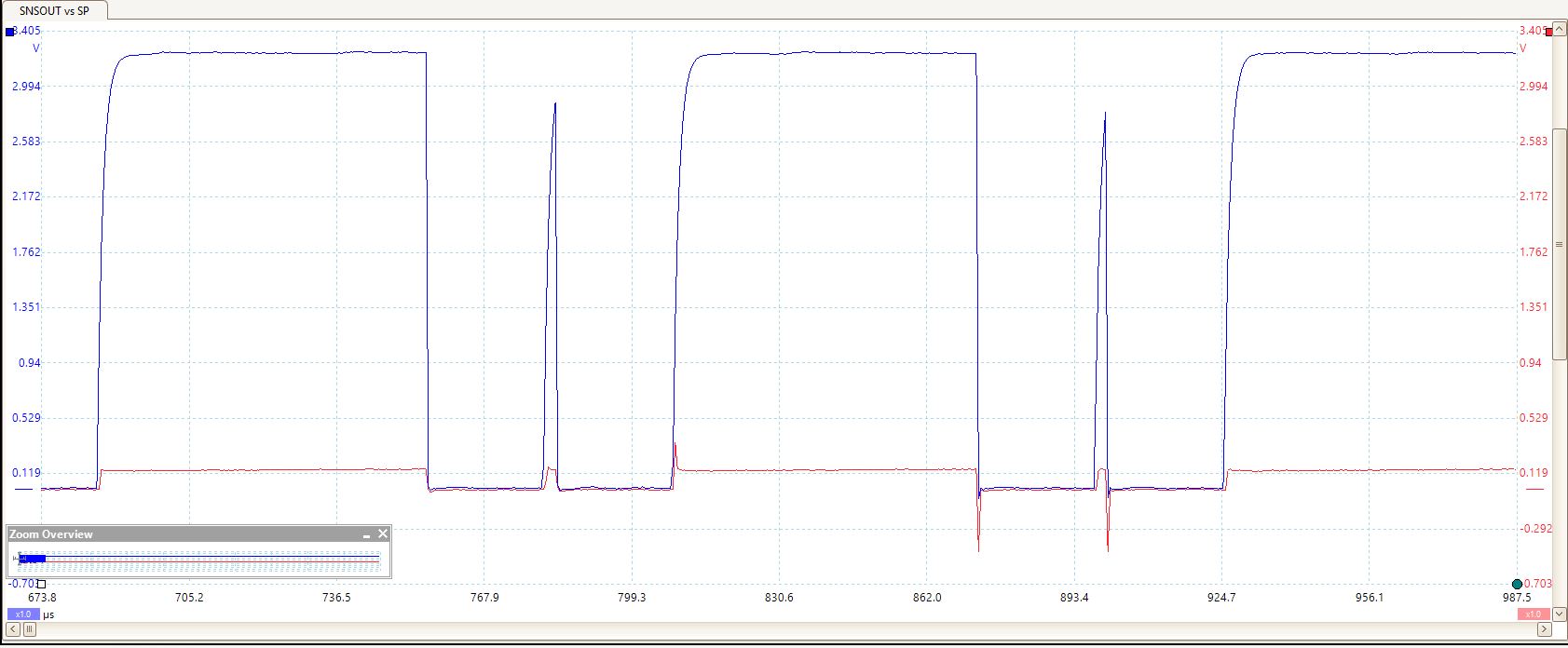

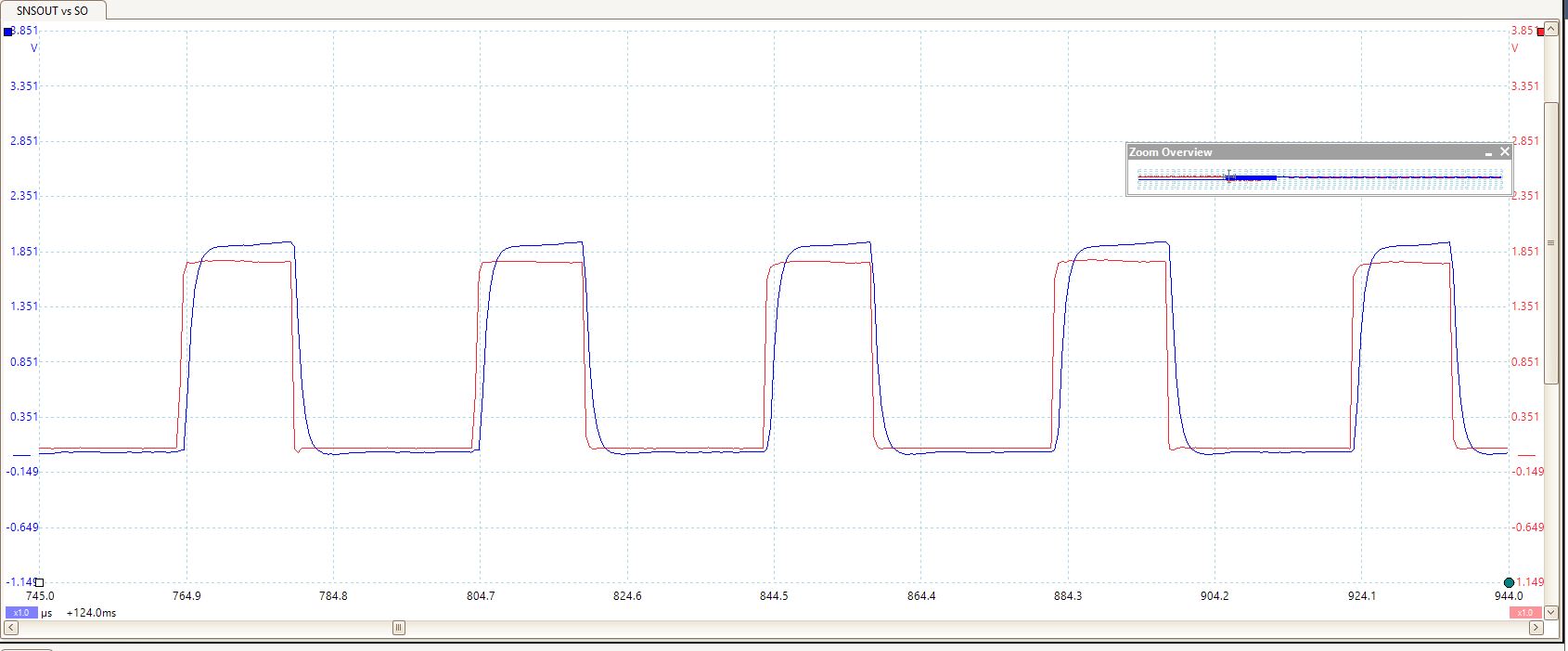

  • Hi Brad,
    I need to work my way backwards from the comparator output the the half-bridges to see if the issue truly comes from the current regulation. I think it might just be from noise on VREF dropping it and on SP (increasing it) or SN (decreasing it) to make SO - VREF < 0 for those intermediate spikes.
    Therefore, can you expand you capture timestamp to 716 to 953 us and, using SNSOUT (blue color) as a reference signal, do scope captures of:
    SNSOUT with SO
    SNSOUT with VREF
    SNSOUT with SP
    SNSOUT with SN
  • Hi Hector,
    Here are the captures you request...
    SNSOUT with SO
    SNSOUT with VREF
    SNSOUT with SP
    SNSOUT with SN

  • Hi Hector,
    Please find attached snapshots of the EVM board (SNSOUT vs SO signal lines). EVM board does not seem to have those "spikes" we observed on our design. Are there any other signals we should capture on the EVM board?
  • Hi Akzhana,
    Since the issue appears to only be ocurring on the customer board, no need to further probe the EVM.
    It appears the scope is not capturing potential noise on VREF or SO or other lines. I suggest a trial of probing with a different scope to see if there is noise on customer PCB that has not been captured. If the noise is on SO or VREF or both, the trace(s) is/are cut on the PCB and blue wired to see if the noise reduces and if the problem goes away.
    Layout improvements have been recommended in the private conversation with Brad.
  • Hi Hector,
    Thanks for your response. Just wanted to clarify -
    Are you suggesting cutting SO or VREF traces on our PCB and wire them to EVM and see if we are still seeing the noise?
