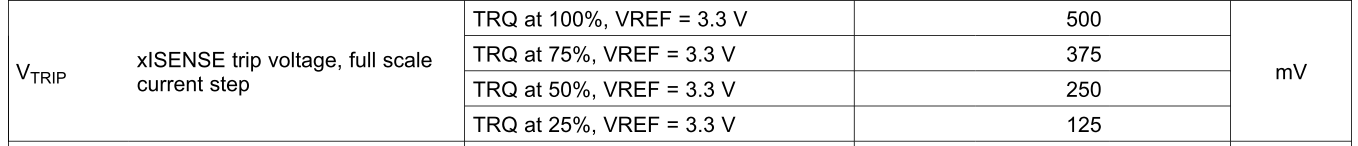

On the forum, "Figure 9 xISEN Full-Scale Trip Voltage value is below formula 1 result. I would think the figure 9 value is the typical value."
Could you refer to the attachment file?
20190528_DRV8881E.pdf
On this attachment file, we assume that follows;
-Vtrip=500mV : Vref=3.40~3.45V
-Vtrip=250mV : Vref=3.5V
So, it is not satisfied with follows;
In case of formula(2), Electrical Characteristics is fitable with Vtrip condition.
However, formula(2) is not equal to Figure9.
So, we would like to calculate the current chopping correctly.

  • Matsumoto-san,
    Yes. We are busy right now. But, e2e support always our key support. I missed the post in the beginning.
    First, Av in the spec table is not ideal 6.6.
    2nd, the spec table number is the official number. Specially, it has min/max number with it. In this case, use AV spec table number and min/max value to estimate the Itrip. The Figure 9 gives additional info. Such as: linear curve, offset idea at lower current setting.

  • Matsumoto-san,
    ->Does it mean which show "AV Amplifier attenuation" on the datasheet P8? Yes.
    Does it mean that there is the difference 6.6(formula(2)) and 6.58(typ)? Yes.
    ->Does it mean which we should consider min/max value to estimate the Itrip? Yes.
    ->does it mean Figure 9 xISEN Full-Scale Trip Voltage value is not below formula(2) correctly? I would think Figure 9 and P8 spec will match at 3.3Vref.
    -> Does it mean which this difference contains additional info such as: linear curve, offset idea at lower current setting?
    If there is any conflict, please use P8 spec table number as reference. Also, when you do the calculation, please use 3.3V REF.
    Use As the conclusion,
    ->Should we calculate Itrip using formula(2)? Yes for 3.3V VREF.
    ->Is Figure9 not suitable for Itrip calculation? It is for the estimation if VREF is not 3.3V.
    If I do the calculation for the Itrip with different VREF value, I will get two points first:
    a. Itrip value from formula(2) with 3.3V VREF
    b. VREF or Itrip Offset from Figure 9
    And then, use a linear equation to estimate the Itrip value from VREF offset pin to 3.3V VREF.

  • Matsumoto-san,
    <Additional question1>
    When the customer uses without VREF=3.3V(For example : 2.7V or 2.0V or 0.5V),
    -Formula is not suitable for current regulation calculation correctly.
    -We should consider Figure9 to estimate current regulation calculation and then we use a linear equation to estimate the Itrip value from VREF offset pin to 3.3V VREF.
    Is our recognition correct?
    Yes.
    <Additional question2>
    Do you have any formula to estimate the correct Itrip in case of lower VREF(For example : 2.7V or 2.0V or 0.5V)?
    <Additional question3>
    We got that there is the difference between Figure9 and formula (2).
    And then, we got that Figure9 contains linear curve and offset idea at lower current setting.
    So, what do you indicate "linear curve and offset idea at lower current setting" concretely?
    What is the Figure 9 error at 3.3VREF? Is it in AV tolerance range? Formula 2 only gives one point data at 3.3V VREF in the spec table. If you want to estimate 2V VREF Itrip, how do you draw a line to match Figure 9 with that one point data? Here is my answer:
