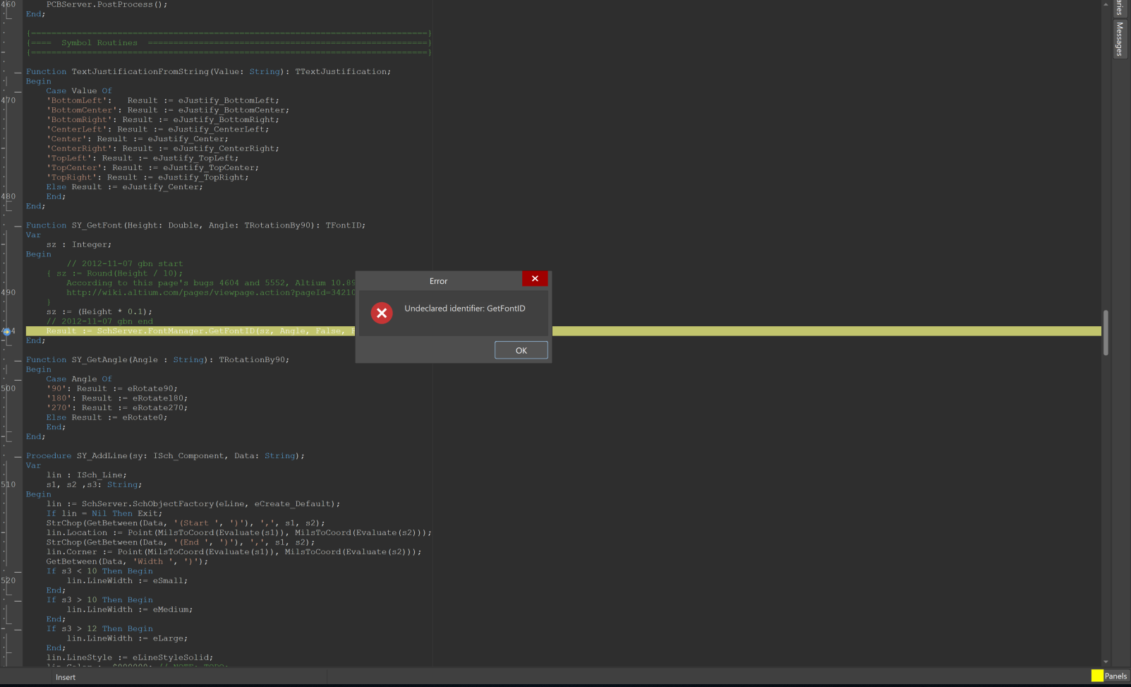

  • Here is the error in altium 19
    For altium 18:for some reason I can't reproduce the problem that triggers the error but the PcbLib that is generated is empty.

    In Altium 19, he is getting the “GetFontID” error.
    • The “GetFontID” error is an issue that was introduced with the release of Altium Designer 19 and affected the scripting files we use to generate Altium components. However, we have fixed this issue with the more recent versions of the Ultra Librarian software.
    If the user is using an older version of the Ultra Librarian Free Reader (version 8.3.103 or older), I recommend downloading the latest version here: https://www.ultralibrarian.com/products/free-reader. We are currently using the 8.3.141 version of software. The more recent software includes bug fixes that specifically identify the “GetFontID” error. Alternately, the user can use our Online Reader to export to the CAD tool of their choice without downloading software.

    In this instance, neither of the failures the user is having is due to the actual .bxl file itself.
