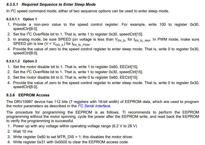

i am using DRV10987D as a driver for Ceiling Fan. 10987D working well but IC is not going into sleep mode. I have entered 0 as a spped command through GUI and providing 0V on speed pin for more than 30 min but it is taking 7mA current.
Please give me suggestion for this issue.
