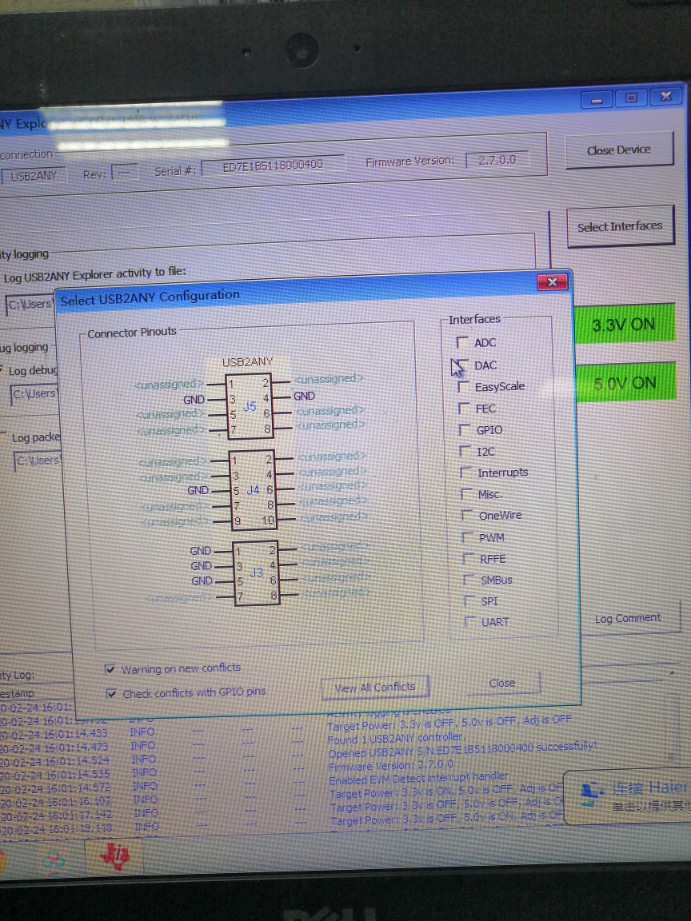

when I click "Enable Configure",A Error Message occur.The message is "DRV10983 USB2ANY.lvclass:Read Register.vi<ERR> Register reading not succesful!! Please restart the GUI and try again". There are two buttons .One is "continue",the other is "cancel". Click "continue" , sometimes it has no response,sometimes a new error message"Notifier Timed Out Device GUI.lvlib:GUI Wait for GUI Response via Notifier.vi:5770006:\DRV10983.lvlib:Export Read All。vi\DRV10983 Hign Level.lvlib:Main.vi". If I click "cancel",the window will close.

Hi Tong,
You shouldn't be making any changes to USB2ANY. Just leave it with the default settings. The device should be powered up for the GUI to communicate to the device. Connect the power supply to VCC and GND. Apply 12V across VCC and GND. This will power up the device and now restart your GUI. Now you should be able to communicate to the device.
