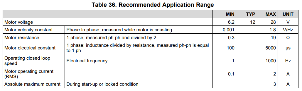

  • Also, make sure your motor falls within the operating range of the device as shown in below table

    Seems like the motor didn't align correctly. Can you try the below recommendations?
    1. Decrease the Open to closed loop threshold frequency to around 25 Hz.
    2. Increase the Align time to 2.7 sec.
    How many poles does your motor have?
    Vishnu
