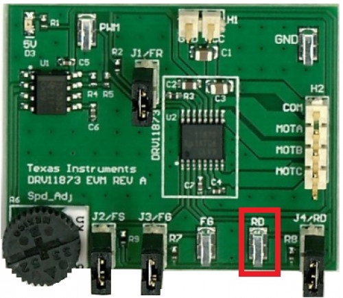

We use your evaluation board DRV11873EVM to test the DRV11873 PWPR again, still found the same problem.
The motor start stop frequently at the voltage 7.3Vdc, attached the photo for your reference, please help to solve the problem.

    DRV11873 has a fixed MAX speed limit of the internal control logic. The limit is FG < 475Hz@FS=0 and 950Hz@FS=1.
    Do you have all the jumpers installed? Does RD pin go high indicating a fault?
    Did you connect the COM of the motor to the COM pin?
    On a side note: This driver is meant for fan motor drive applications, and might not be optimized for your motor. There are very few settings to tune with this driver. An alternative part to suggest is the DRV10975 or DRV10987, which allow for far more customization for more motor types.

    Thanks for sharing the details. Note that FS is latched upon power to the EVM so power must be cycled in order for the FS output to change. I would recommend you to remove the jumper J3 and power cycle because your motor is a high speed, low resistance motor. What is the motor voltage rating? Note that the maximum speed can be achieved only when the supply voltage is greater than or equal to the rated motor voltage. You cannot expect the motor speed to be at maximum speed throughout the Vcc range. With Jumper J4 connected, can you check and see if the RD pin as shown in the below pic is pulled high?
    Regarding the alternative part, yes both devices have evaluation boards. Please check DRV10975EVM and DRV10987EVM.
    Vishnu

    Did you check the status of RD pin? We need this information to know if the motor has entered a lock protection state.
    Do you see this behavior when Vcc ramps through 7.3V or when the Vcc is set constant at 7.3V?
    Vishnu

  • Hi Adolf,
    When the FS pin is tied to GND, the DRV11873 is set for optimized startup for low fan speed motors with high motor winding resistance and high inductance. With the jumper out, the FS pin pulls up to VCC through a pull-up resistor. When the FS pin is tied to VCC, the DRV11873 is optimized for startup for high speed fan motors with low motor winding resistance and high inductance. I am not sure why there is a problem specifically in that voltage range. Also, we haven't seen such issues in the past.
