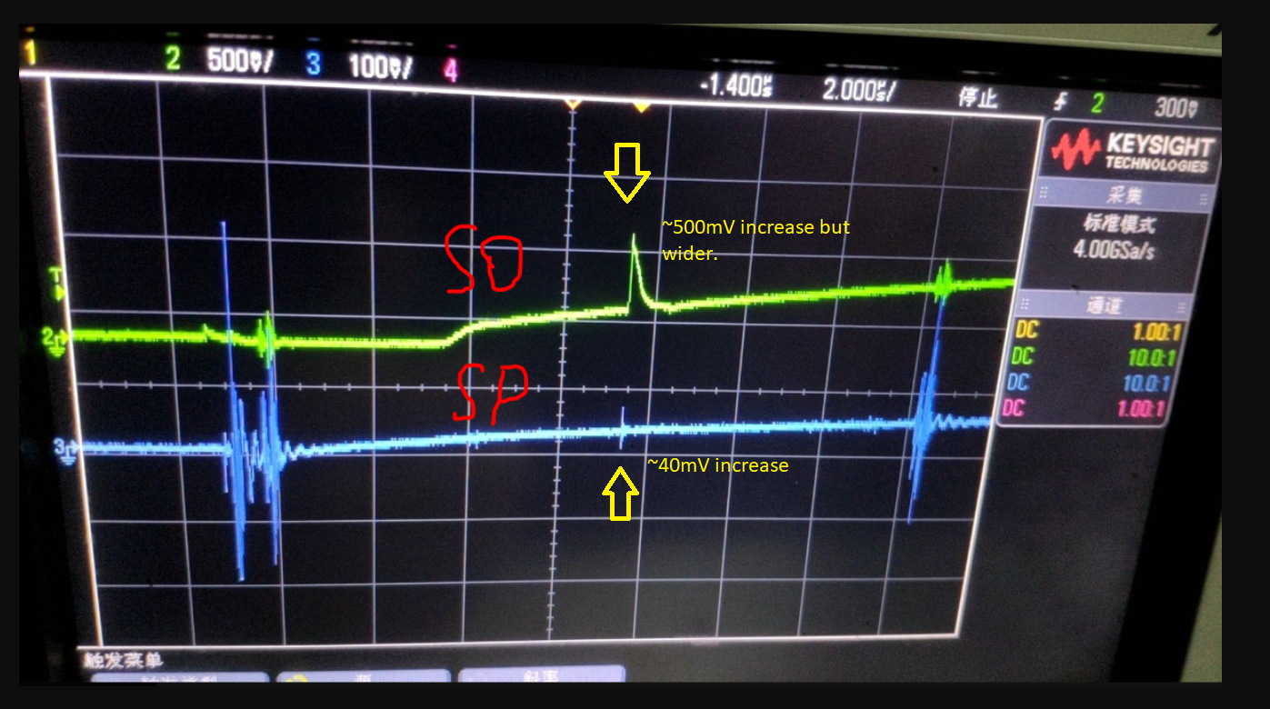

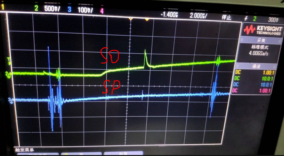

Hi team,
I test the SO waveform in the DRV8701 EVM board. There is a strange pulse pulse. But it work normally.
DO you know why?
Thanks!

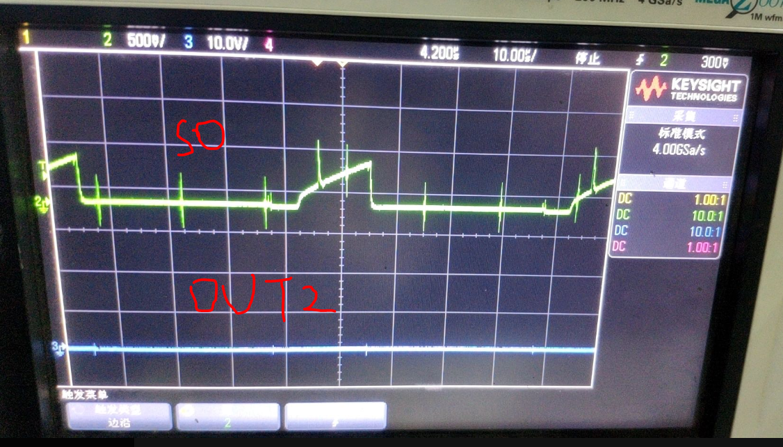

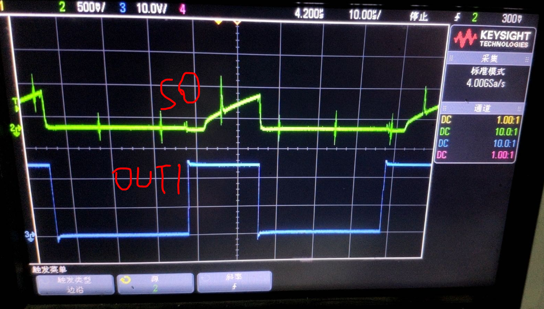

Hi Eggsy,
What load is connected across OUT1 and OUT2?
Does the load have a capacitor connected across OUT1 and OUT2?
Can you also provide the voltages on the SP, OUT1, and OUT2 pins on Channel 1?
This will help us determine the cause.
Hi Eggsy,
Sorry for the delay.
Please see the image below. The SO pulse is consistent with the increase on SP.
The increase on SP appears to be ~40mV which translates to an increase of ~800mV on SO.
A capacitor on the SO output will slow the increase and lengthen the width.
Does the customer have a current probe to confirm the increase on SP is correct?
If this increase is correct, what is causing the increase?
