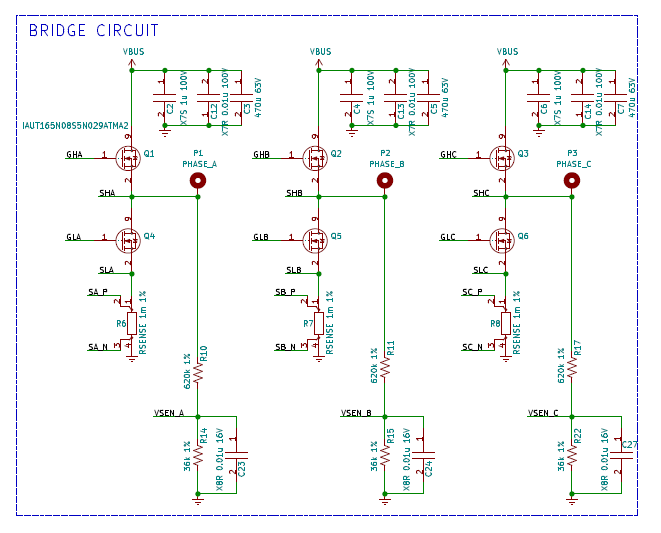

Circuit Diagram Here:
DRV8353 Circuit:
When running Lab01c of the InstaSPIN-FOC (closed-loop current control for signal chain verification), I'm getting a gate drive fault (GDF) from the DRV8305 when the motor was about to spin. What's weird is I'm getting the fault at a specific MOSFET (GL_C) every single time.

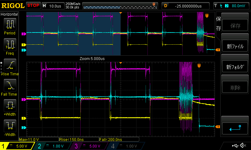

Waveform:
So I tried capturing the gate drive VG_LC, the motor terminal voltage at C, and the FAULT pin just before the error has occurred.
  • Channel 1 (Yellow) is gate drive C
  • Channel 2 (Skyblue) is
  • Channel 3 (Pink) is Vc (terminal voltage at C)
As you can see, in the last cycle I encountered some weird ringing on the gate drive which in turn falsely triggers the MOSFET (or so I'm thinking), disrupting the signal chain.
What's weird is that the weird noise also appeared on the FAULT signal.
I'd really appreciate if anyone of you would give any hints/ideas/suggestions on how I may further debug this problem.

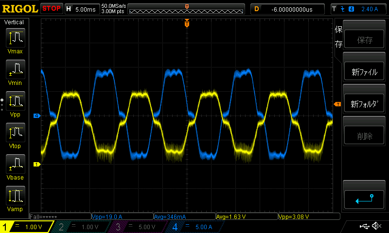

    So I took your advice and checked my current gains. I also verified the integrity of the current waveforms at my DAC output.
    It seems that I followed the instructions for setting the current gains as of the instructions.
    Here is what I'm getting. The blue line is the one from an external current sensor and the yellow one is the DAC output of the current reading at the same phase.
    I took that waveform when running lab01b (cause anything beyond that won't run).
    Waveform 1: Current Waveform, lab01b, using my Custom Power Section
    It seems that the current waveform output by the DAC was cluttered with PWM noise. I hypothesized that this may be caused by a dirty raw input signal to the sense amplifiers.

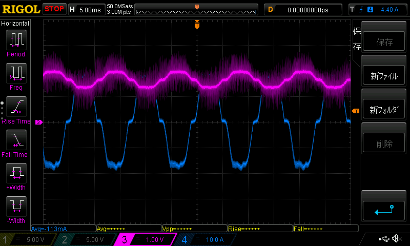

    For comparison, I probed the same signals but using a DRV8305EVM Power Section:
    Waveform 2: Current Waveform, lab01b, using DRV8305EVM Power Section
    Obviously the current scaling will be different because the two boards have different sense resistor values and current sense amplifier gains.
    The current waveform output at the DAC, in this case, is significantly cleaner than Waveform I. So I checked the schematics of my custom power section and noticed the capacitor across the sense resistor is missing. I added a 2.2nF capacitor across the sense resistors to verify if this is indeed the case.
    I tried loading up lab01b again to check the current waveforms if they changed.
    Waveform 3: Current Waveform, lab01b, using custom power section, with Rsense capacitors
    Notice here that the DAC output waveform is now on channel 3. I couldn't notice an improvement on the waveform. Could this just be normal?

  • I have to add another information that I only noticed just now.
    The phase B shunt resistor terminals SB_P and SB_N are wrongly connected to the DRV8353  (pin 13 and 14). This is an honest design miss. I just noticed the case when I was trying to reconstruct the bus current from the phase currents.
    I'm starting to think that this is causing the failure of the InstaSPIN-FOC to start.
    I'll try to modify the board to fix the circuit then I'll let you know how it goes.
  • And yes, the above was the cause all along. The inverted SB_P and SB_N on the circuit was causing all the mishaps. Consider this case closed.
