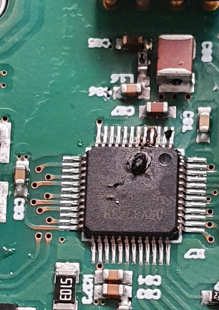

I would like to use the IC in 4 quadrant (servo) operation. By using the INHA pin on high and the INHC pin as pwm Pin.
This works fine with 24V but I need to use 48V. Since the IC is designed for up to 60 V that shoud work I guess using VM=48V.
But it broke after a short time. Is there something you have to consider with VM= 48V? e.g. lower CVCP.
This is Picture of my circuit:

  • Patrick,
    Thanks for posting on the MD forum!
    Do you have an idea of where the damage occurred?
    If possible could you remove the IC from the PCB and measure the resistance of the output pins to GND? Then compare this to a known good device and let us know.

  • Hello Adam
    The damage is near the VM Pin(Pin4). The resistance of the VM Pin to ground is ca 1R. Normal is 1M+ on IC or 25K on PBC.

  • Hi Patrick,
    Can you confirm that the 1-ohm resistance you measured from VM to GND was with the IC removed from the board?
    Also, in your schematic, can you explain what "+VB" and "POWER_MOT/5.4E" is and whether they are connected or not?
  • Hi Aaron
    The 1-ohm resistance was on my Board and after i unsoildering it on the IC.
    +VB and POWER_MOT have the same source. The POWER_MOT signal do have 2 extra MOSFETS for an securely feature. But for the tests both MOSFETS where open from the start.
    Yes they are connected.
    I hope this coud help you.
  • Hi Patrick,
    Could you clarify what you mean by "open" when you say the MOSFETs are open from the start?
    If VDRAIN and VM are not directly connected together, then a transient at SHx that exceeds VM by more than 10-V could cause damage to the device by exceeding the VCP absolute max value.
  • Hello Aaron
    POWER_MOT is 48V from the beginning.
    I have atm 22uF + 4,7uF +100nF+33nF at VM is this to mutch or shoud it be ok?
    OK i try to direct conect the VM the C´s to POWER_MOT and look if it goes better.
    Thanks.
  • Hello Patrick,
    Your bypass capacitors at VM should be fine.
    Let me know the results when POWER_MOT and VM are connected together.
    I would also recommend looking into the DRV8350H if you want a gate driver that is rated for 48-V systems. The DRV8350 is rated for up to 100-V and the hardware variant can support the same circuitry you are using for the DRV8343H-Q1 in your current design.
  • Hello Aaron
    The connection of POWER_MOT and VM are good and i was able to drive all kind of 48V Motors that we have here :-) . Thanks for your support.
