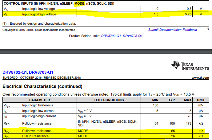

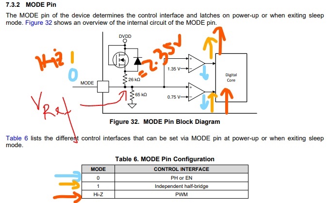

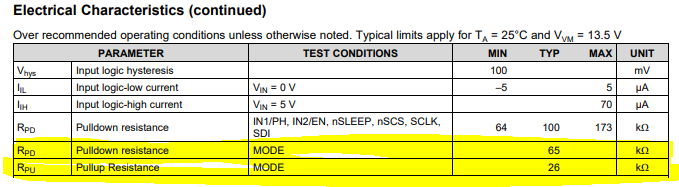

My question:
I want to use PWM control on IN_1 and IN_2 (similar to DRV8701P i used before)
Leaving Mode pin floating or connect to a mcu input without pullup or pulldown the mode vref will be 2.35V and not 1.05V please see pictures from datashhet.
Vef = 2.35V = DVDD(3.3v)*65K/(65K+26K)
Can i use a resistor with 14k in parallel with 65K to be equivalent to 12K. Vref will be DVDD(3.3)*12k/(12k+26k) = 1.04 V ?
