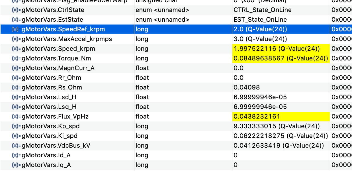

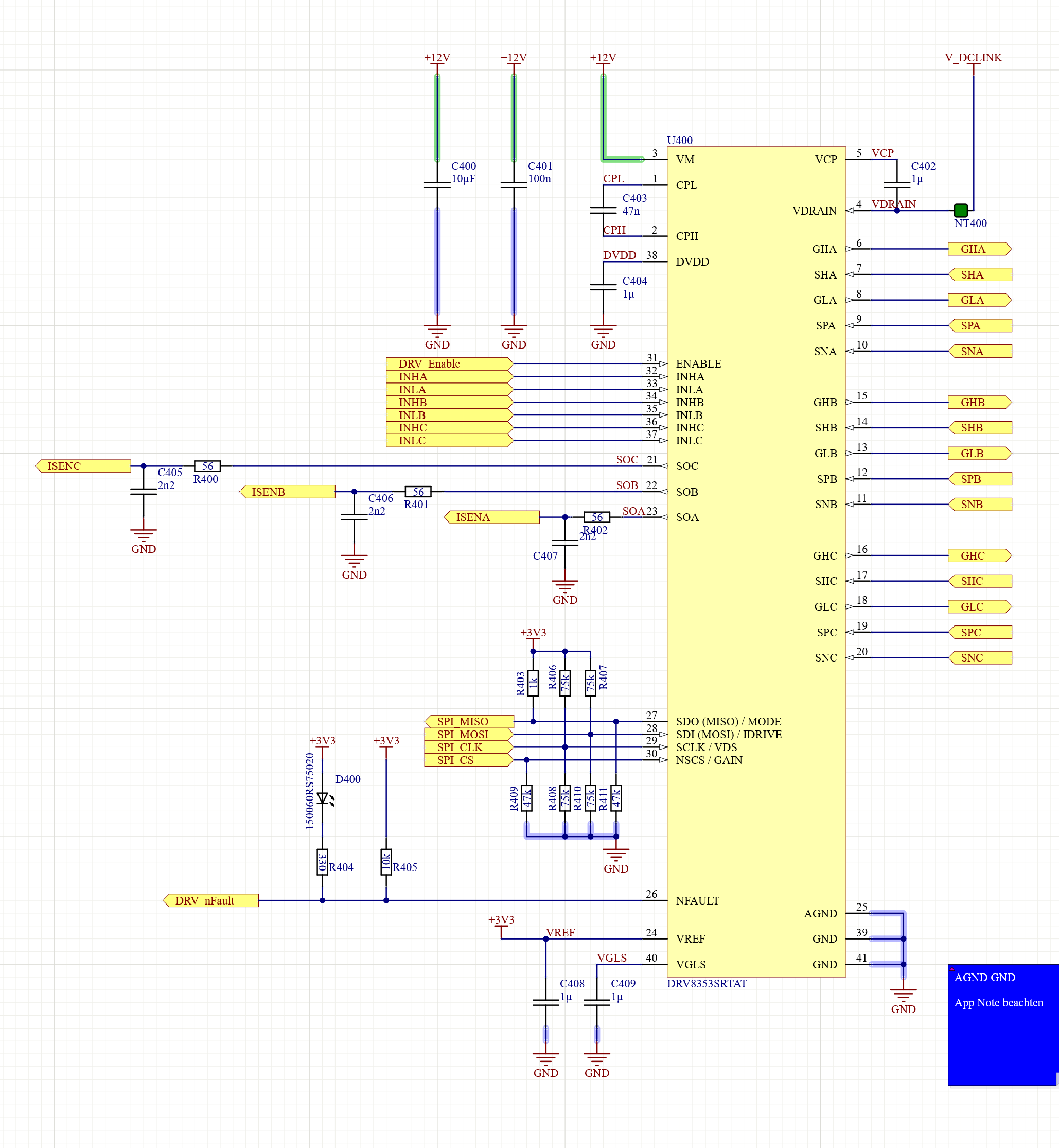

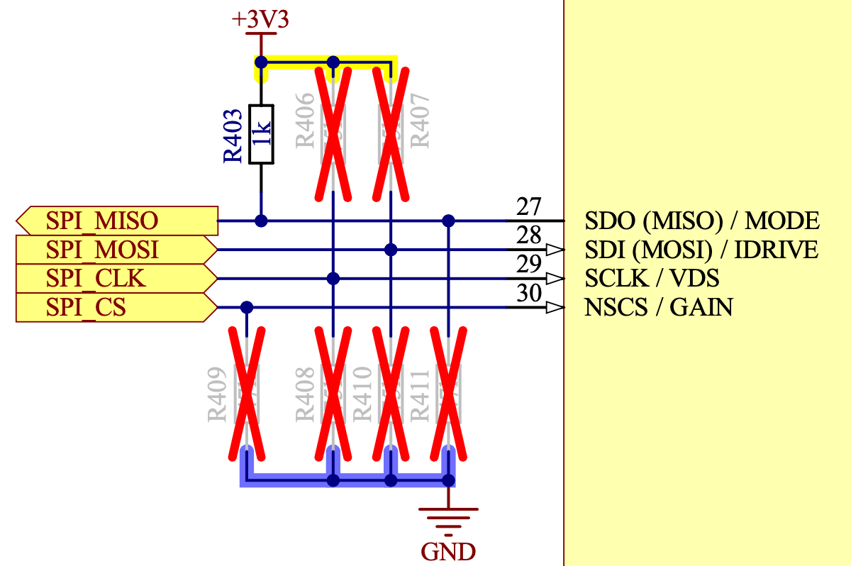

I just soldered my own designed controller board. I based it on the DRV8353 EV and DRV8301-69 kit. So I'm using F28069F processor and DRV8353 driver, because my battery voltage has a maximum of about 58V.
So, what have I done so far?
- I did all instapsin-FOC labs with DRV8301-69 EV kit
- I did the modified lab 05b with DRV8353 EVM - but it is somehow current limited, see below.
- And I prefere to use the 11e project as a base, because I need current control and I need to startup with Hall sensors at low rpm and need then to switch to FAST. I tried without HALL, but it is not a good experience under load, starting from zero...

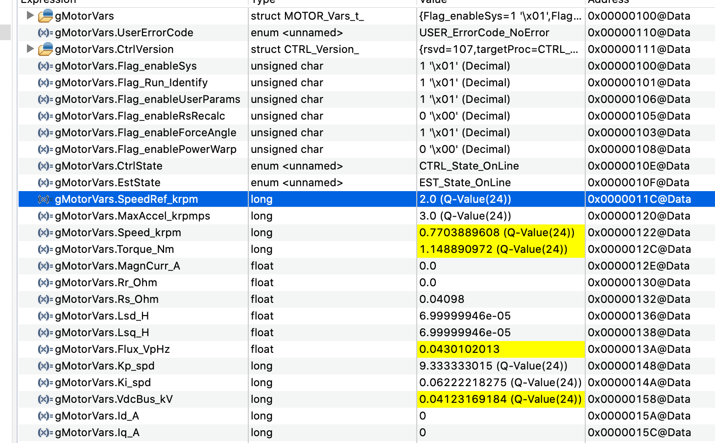

Now coming to my own board. I have done the following:
- Modified the Lab05b_drv8353 to meet my custom board and F28069F and it is running, but somehow power limited. I can set for example 2000 rpm, but as soon as I put load on it, it drops down to 1200 rpm. Current on power supply side is then about 2A. No matter what I increase in request in gMotorVars.SpeedRef_krpm. Any idea why is this ?When motor is stopped, I see sometime jumps up to 9000/4000 in gMotorVars.Speed_krpm. I noticed a jump in voltage measurement of phase C. It goes from 0.0 sometime up to -2.0... But ADC value in ADCResult does not jump... I did check back with DRV8353H EV kit, and it has the same behavior... motor is running on 2000 rpm, I put load on it, current goes up to 4 amps, and then motor is slowing down to about 1200 rpm and 2A from power supply. Power supply can definitely deliver more power than that. Is here some limitation active in DRV8353 or something ? my USER_MOTOR_MAX_CURRENT is set to 14.0 A.
- And on project 11e, nothing is really working... When I only enable the Identify and enableSys Flags, in hall mode motor starts turning backwards (about 1000 - 2000 rpm), but FS_IQ_ref is 0.0 and in current control mode, motor does not start, just a short try in turn of the motor, followed by complete shutdown --> hitting pause on debugging shows message: break at adress xxx with no debug information available...
So to summarize:
So, from my point of view, my modified 05b is more working, but 11e is more like the featureset I need in the end (current control and HALL startup)
My questions:
1) Do you have an idea, why 05b project is somehow current limited ?
2) Do you have an idea, what is wrong in 11e for my custom board ?

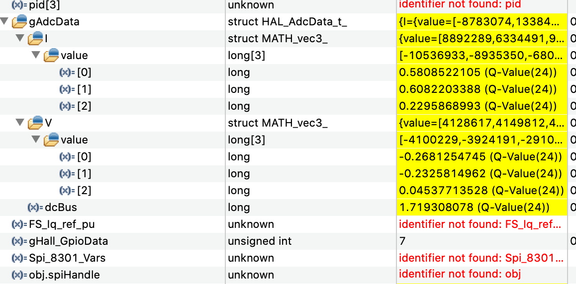

3) What I can imagine: I'm not sure, how to get/calculate the I_offsets and V_offsets. They are quite different in the projects for drv8353 and drv8301 ---> How Do I get these values?
4) current and voltage scale factors should  I did calculate and change the approbiate values in user.h. I attach my user.h, and my schematic.
0871.user.hI'm using the same files for 05b and 11e (Hal, user.h, drv8353 etc.)
proj_lab05b_drv8353_modified.rtf
proj_lab11e_modified.rtf

  • Oh, and here additionally to show you some values from the 05b lab running:
    No Load, working ok (run with DRV8353H EV):
    And with load, only 1148 rpm instead of requested 2000 while only needing 1.8A from the power supply, which can deliver 10A (run with DRV8353H EV):
    And here is the current voltage measuring during that (2000 rpm request, but only 1148 supplied):
  • Hi Paul,
    Thank you for posting your questions on the MD forum!
    I have reviewed your schematic, and overall the schematic looks good. I don't think the below questions are related to your issues, but I went ahead and reviewed the whole schematic anyway:
    • What are the voltage ratings on the capacitors connected to pins VM, Vdrain - VCP,CPH - CPL, DVDD, and VGLS? also what is the voltage rating of the capacitor attached to V_DCLINK?
    • The capacitor on the Vref pin is usually 0.1uF, but the 1uF capacitor that you have should be fine.
    • Are you using the hardware version of the device or the software version? Or are you designing your EVM to support both?
    • which of the pull up/pull down resistors attached to the SDO/Mode pin, the SDI/IDRIVE pin, the SCLK/VDS pin, and the NSCS/Gain pin are actually populated on the board? Depending on the device (hardware vs software) not all of those resistors are needed.
    Once we have finished answering all your questions regarding the schematic I will forward your post to the C2000 team to answer your software related questions.
    Anthony Lodi
    thanks for reply.
    Regarding your questions:
    1) Capacitor voltage ratings
    VM is running with 12V, C400 is 50 volts, C401 is 100V.
    CPH-CPL: 100V
    DVDD: 16V
    VGLS: 16V
    VCP-VDRAIN: 100V
    2) Yeah, I did hardware design for Hardware and SPI variant of the DRV8353. Right now I'm using SPI version. Here is the assembly version for my SPI variant:
    I tried also to run some projects 01b, 01c, 02c... And every time, these projects try to run the motor, none of them can spin motor and most of the time debugger loses connections after a short turn of the motor and immediate stop... only the modified 05b project, you created for the drv8353, this one is working, but like I said with some kind of power limitation, but the behavior is the same as running it on the "original" hardware and original project.
    And like I said, I run the 05b working project and all the other projects, which are not working on the same hal.c, hal.h, user.h, drv8353 files.
    So something must be quite different in the program itself, which I did not discover yet...
  • Ok, and I found out, that the speed limitation in 05b comes from current limitation. I assumed that the USER_MOTOR_MAX_CURRENT parameter was meant to do on the power supply side. Apparently it seems to me the sum of the three phase currents. Is that correct ? I just measured 4.5A in one phase, so multiplied by 3 it is more or less 14A.

  • Hi Paul,
    Thank you for the additional information! From the schematic point of view everything looks good. The 50V rating for C400 is fine with the 12V VM you are using, but I would consider changing it to a higher voltage rating if you decide to use a VM larger than 25V. Additionally I didn't see a voltage rating for C500, but as long as it is  rated for 2x larger than the voltage at V_DCLINK than it should work fine.
    Thank you for your clarification on the pull up/pull down resistors. It looks like you are doing everything correctly, but you may want to consider adding an option to tie the NSCS/Gain pin to DVDD to give you the option of the highest gain for the hardware version.
    We suggest using the lowest Idrive setting (50mA/100mA source/sink) since the MOSFET QGD is 18nC for the transistors that you are using. This would result in a 360nS/180nS rise/fall time respectively. If the Idrive setting is too high for a particular MOSFET, that can cause ringing and EMI issues. The lowest Idrive setting should be the best setting to use for your design.
    I am now going to internally forward your post to the C2000 team to answer your questions about the 05b and 11e projects. The post will remain in the MD forum, but the C2000 team will be responding to the post.

    I just noticed one difference between your eval boards and my board.
    I have a different phase order on the EPWM1-3. You have always Phase A to EPWM 1, B to EPWM 2, C to EPWM3.
    I have A on EPWM 3, B on EPWM 1, C on EPWM 2. I did change the PWM Init to fit this, but unfortaentely with this, the program just crashes...
      // initialize PWM handles
      obj->pwmHandle[0] = PWM_init((void *)PWM_ePWM3_BASE_ADDR,sizeof(PWM_Obj));
      obj->pwmHandle[1] = PWM_init((void *)PWM_ePWM1_BASE_ADDR,sizeof(PWM_Obj));
      obj->pwmHandle[2] = PWM_init((void *)PWM_ePWM2_BASE_ADDR,sizeof(PWM_Obj));
    Do I have to consider other places also where this needs to be changed ?
  • Ok, I found out my problem.
    I have Phase B on PWM 1, Phase C on PWM 2 and Phase A on PWM 1, but I did not adjust ISENA, ISENB, ISENC, VSENA, VSENB, VSENC. So current and voltage measurement were completely mixed up/switched.
    After adjusting current and voltage measurement everything is working as expected.
    I found out what the issue was: My PWM 1, 2, 3, are in different order than the original one, but I did not change VSENA, VSENB, VSENC and ISENA, ISENB, ISENC accordingly to the Motor phase order. After fixing this, everything is working now.

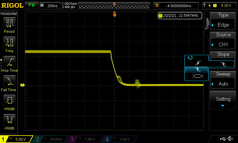

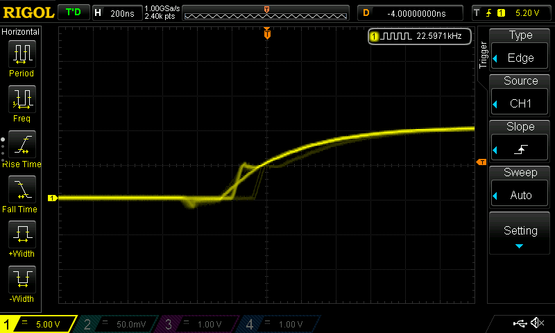

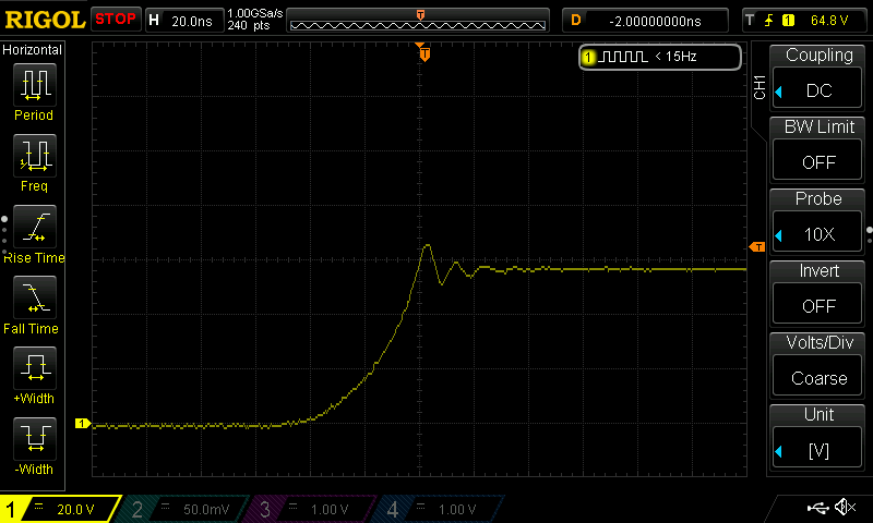

  • Hi Anthony,
    sorry for my late reply. I was able to reduce the overshoot to 65V. Here is the screenshot of the Gate Source. The Hall Sensor order was not quite right, that's why on startup I had an bigger overshoot. Now this my worst case overshoot (startup current with my maximum allowed current):
    This is a 0p400/0p800 setting with the already mentioned Infineon MOSFET:
  • Hi Paul,
    Thank you for your response!
    1. Just to confirm, is the measurement on this plot measured from the high side gate referenced to ground? Would you be able to provide a plot of the high side gate referenced to the high side source of the MOSFET?
    2. It appears that the time scale on this plot is 20nS. This would result in a turn on time of about 40nS, which is extremely quick and could possibly damage the driver.. I wouldn't recommend going higher than the lowest IDRIVE setting based on the MOSFETs you are using. One alternative solution would be to add a gate resistor on the MOSFETs which would allow some more flexibility to use a slightly higher IDRIVE setting.
    3. What is your VDRAIN voltage?
    Anthony Lodi
  • Hi Anthony,
    sorry for late reply. A lot of things to do. To your questions:
    1) I did a mistake in describing: It is Drain/Soure Voltage from one LowSide MOSFET. I will provide another measurement of the highSide Drain Source. And I will also provide Gate/Source as you requested.
    2) What exactly is your concern with faster switching time ? From my understanding. The overshooting voltage should not reach the voltage limits. Even your Evaluation board DRV8353 EVM does faster switching than the lowest IDRIVE setting. So what exactly can be damaged inside the driver ?
    3) VDRAIN is battery voltage, which 58.8V fully charged.
  • Hi Paul,
    1) Thanks for the clarification! Once you are able to provide the Gate/Source measurement of the high side gate and the low side gate that will help to better see the effects of the IDRIVE that you are using
    2) PCB layout can greatly effect the amount of ringing/overshoot that is present on the gate of a MOSFET when switching. So it is possible to have one design that has a faster switching time than another design, yet the amount of ringing could be less due to the layout techniques that were used. Even though our EVM has a pretty fast turn on time, the layout techniques that were used during the design of the EVM help reduce the amount of ringing. Additionally, the turn on time that is shown in the plot that you provided is about 40nS, which is a lot faster than the switching time of our EVM. Hopefully that helps clarify my concern. The gate/source measurements will give greater clarity on the effects that this IDRIVE setting has on your particular design.
    3) Thank you for this information!
    Anthony Lodi

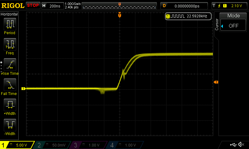

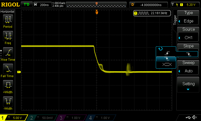

    so, today I was able to do the measurements. Would be great, if you can have a look and tell me if something is not ok from your experience.
    LowSide MOSFET: Gate Source - ON:
    LowSide MOSFET: Gate Source - OFF:
    HighSide MOSFET: Gate Source - ON:
    HighSide MOSFET: Gate Source - OFF:
  • Hi Paul,

  • Hi Anthony,
    1) I'm using still 400mA/ 800mA
    2) Gate traces are 0.221mm.
    3) I don't have a specific time. I just noticed, with slower switching, it generates a lot of heat. Heat means it is not so efficient.
    Do you have some concerns after seeing the oscillograph images ?
  • Hi Paul,
    When you used a lower IDRIVE setting and saw that the MOSFETs were heating up, did you observe that it was primarily the high side MOSFETs that were heating up? If you notice in your plots, the time it takes for the VGS to increase to 10V on the high side MOSFET is much slower than the rest. This could be why you were seeing heating issues at low IDRIVE settings. In order to better understand what is going on, it would be helpful to have a scope plot showing the high side drain to source for both rise and fall times, and then repeat this for the low side MOSFET. You will probably need to decrease your IDRIVE settings substantially for the low side MOSFET turn on and turn off, as well as for your high side turn off, but you will probably need to use an IDRIVE for the high side turn on that is higher than the other IDRIVE settings.
    Anthony Lodi
