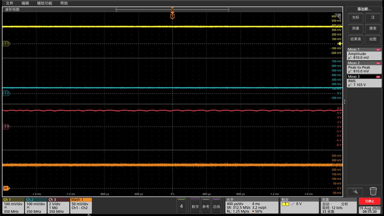

  • Hi Luis,
      The differential noise from OUT+ - OUT- is smaller while the PVDD connected to external power source compare to connect to BST pin.
        -- While PVDD connected to external power source:  The amplitude of (OUT+ - OUT-) is 34.03mv, and Peak-Peak is 395.3mV;
        --While PVDD connected to BST Pin: The amplitude of (OUT+ - OUT-) is 810.0mV, and Peak-Peak is 810.0 mV;
      It seems the BOOST output has affected the OUT+/OUT-,  could you kindly help give comments on how to fix this issue and potential root cause?
      Expect for your kindly reply, thanks.
    Test Waveforms:
      The figure shown the test waveform which connected to external PVDD.
       C1:  IN+;   C2:  IN-;  Math 1: IN+ - IN-;   C3: OUT+ - OUT-
      The figure 2 shown the test waveform while PVDD connected to BST PIN;
    Best Regards
    Benjamin
