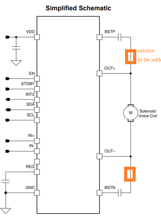

 As the question have been asked before, we have met an EMC issue when we used the DRV2510 or DRV2511 as below link
https://e2e.ti.com/support/motor-drivers/f/38/p/886230/3300812?tisearch=e2e-quicksearch&keymatch=drv2510%20radio#3300812
Additionally,  even if we did not input any signal to DRV2510 through IN+ and IN- port, which means the out port of the DRV2510 presents
duty 50%, frequency 400KHz PWM in both OUT pin, unsolved (especially in pinpoint of 1.2M, and wide range of FM broadcast band) noise issue have been observed.
  For the purpose that we can clear this problem, we consider to insert resistors to bootstrap pin, that slowed the charge time of bootstrap.
Could you provide any advice and suggestion whether that will be any concerns if a resistor be added.
