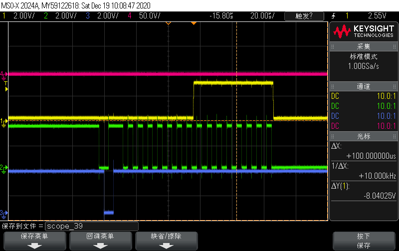

  • The following are the waveforms that the fault register can read correctly and the waveforms that can not be read correctly under the two test conditions of drv8860. The first two waveforms are all open circuit conditions for 8 out, and only the fault register is read. The last two are the conditions of out1 open circuit and out8 over-current. The program circulates to read the fault register, then clear the fault register, and then write to the data register 0x00. The only difference between right and wrong is that the program that reads the fault register has an extra clock high and clock low at the beginning.

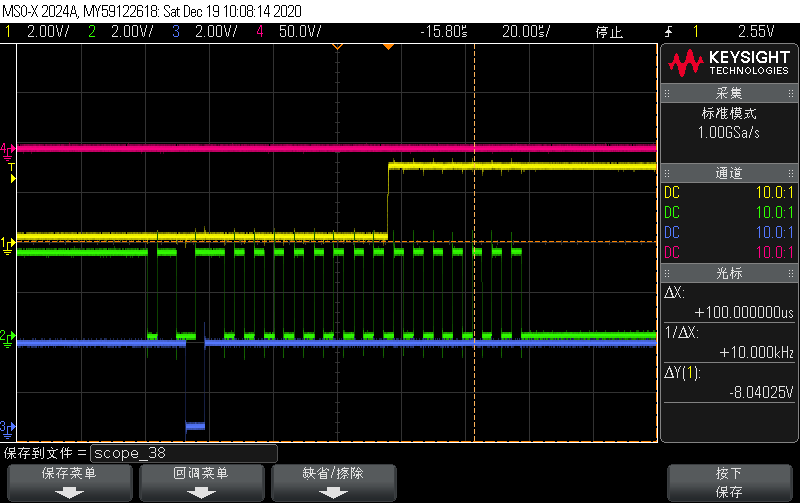

    1、The following is the correct test waveform (all 8 out remain open)
    The data read by the fault register is correct: 0b0000 0000 1111 1111.
    The function of reading fault register is:

    2、The following is the wrong test waveform (all 8 out remain open)
    The data read by the fault register is Error: 0b0000 0000 1111 1110.

    3、Correct waveform of the second test condition (out1 open circuit, out8 over current)
    a.The procedure is similar with the first one.
    b.After reading the fault register, execute the clear fault register instruction, and then write 0x00 to the data register.
    c.The data read by the fault register is correct: 0b1000 0000 0000 0001.

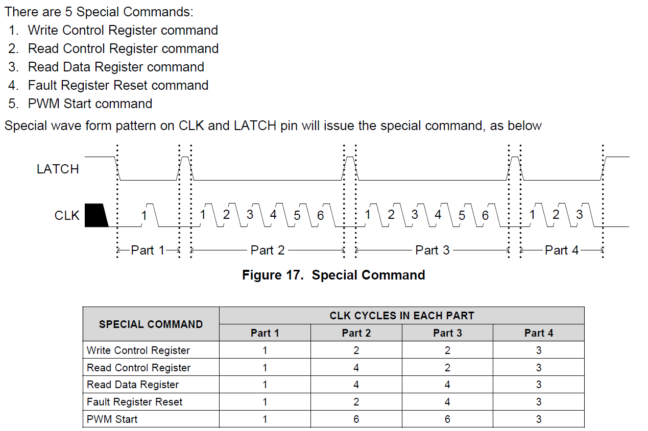

    I just checked the datasheet: There are 5 Special Commands need a extra click signal (part 1 clock) in front of the latch pulse. Does it explain your case?
  • Hi,WangLi
    I understand the meaning of your reply, but it has nothing to do with the reading fault register question I consulted. Reading the fault register does not belong to 5 special instructions.

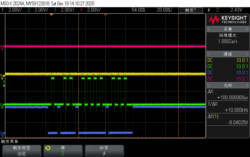

    Thank you very much for your reply.I am sure that the special instruction to reset the fault register is correct. In addition, it may be that my expression is not clear. The error of first reading the fault register exists in both cases. First, the program is executed from main, the first reading is wrong, and the second consecutive reading is correct. Second, as long as the fault register is reset, the first reading is wrong, and the second consecutive reading is correct.The middle section of the test waveform of this problem has the waveform of resetting the fault register.
    Below, I will attach a separate reset operation waveform.
    Yellow color:  DOUT
    Green color: CLK
    Blue color: LATCH
    Red color:  DIN
