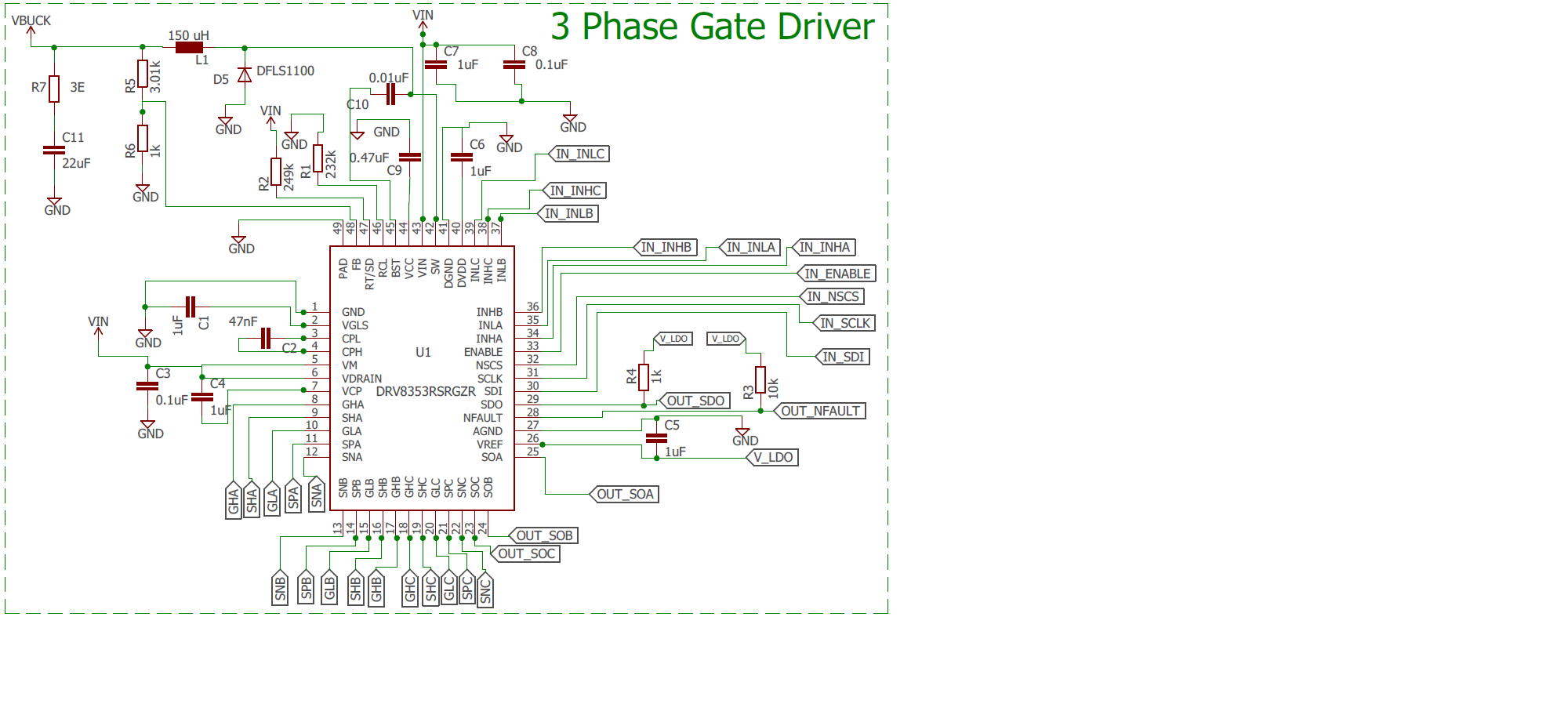

Here is the schematic of Gate driver connections
   When I increases VIN=VM=VDRAIN more than 20volts motors stops working and gate driver fault pin(pin 28) is pulled logic 0 and gate gate driver starts heating very fast i.e., it is damaged.
When I tried with some other board same problem is coming.
I connected gate driver as mentioned in its datasheet.
Also checked with SPI communication after detaching power board(i.e., MOSFET Inverter to whom gate driver is switching) and Read the fault register 1 it is showing 10bit high which means fault is present and the read the fault register 2 it's 6 bit is high indicating VCP and VGLS is not building.
When I checked(C4<7 volts and C1<7 volts but C6 >5 volts) it was lower than the threshold value.
VIN=VM=VDRAIN are rated for more than 90volts so 48 volts should be fine to apply.
Also all logic circuit are supplied from buck converter of gate driver (configured at 10v) in cascade with an LDO 3.3volt.

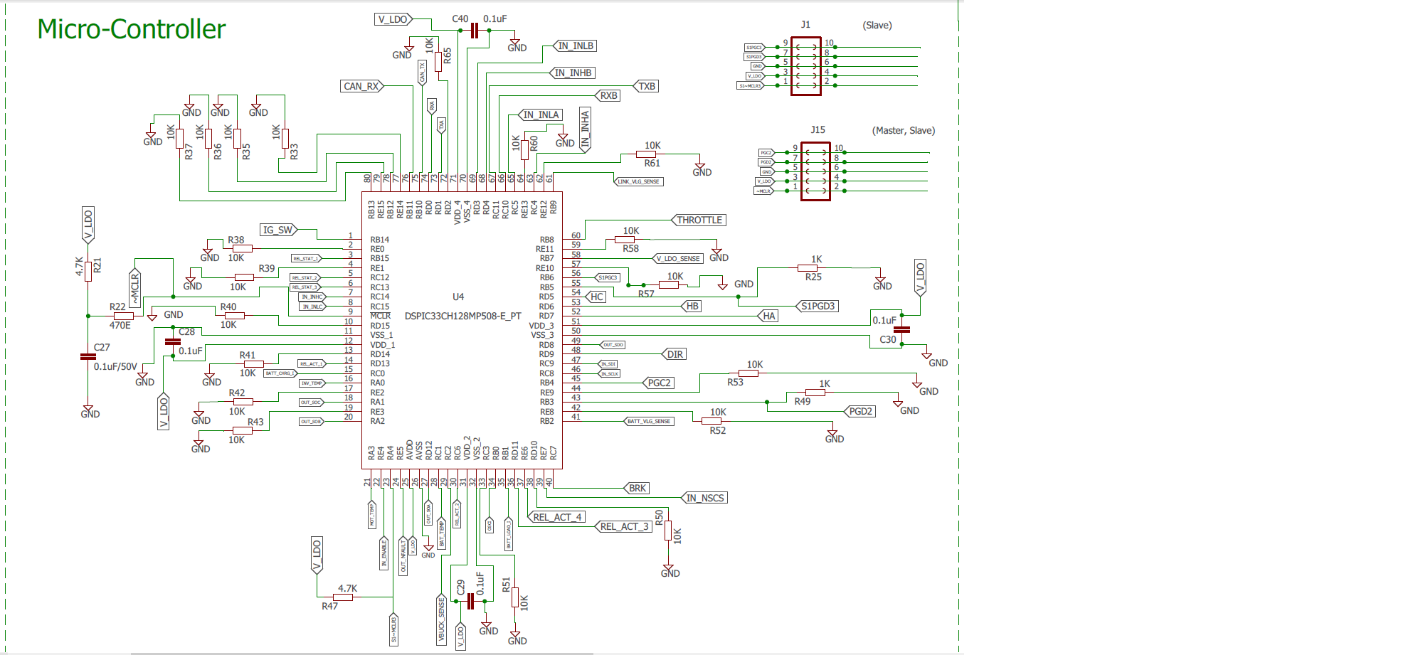

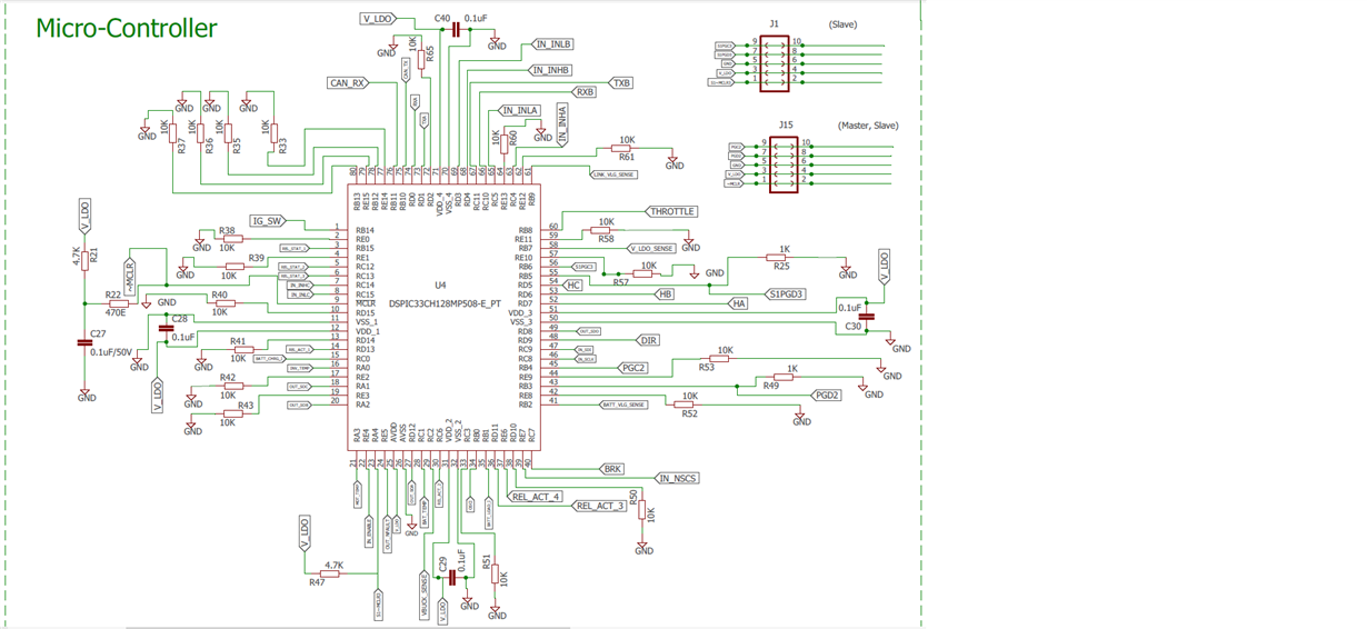

Here I am attaching my microcontroller schematics also for your reference.
I am not able to detect the problem please help me.

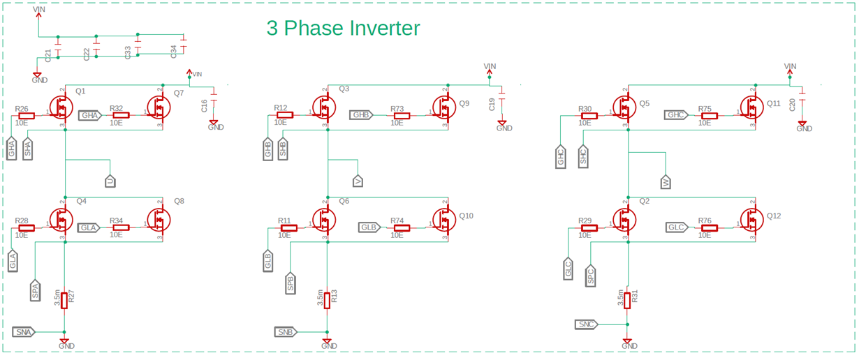

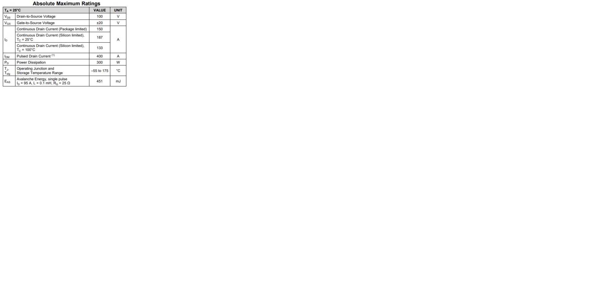

Also Mosfet are rated as

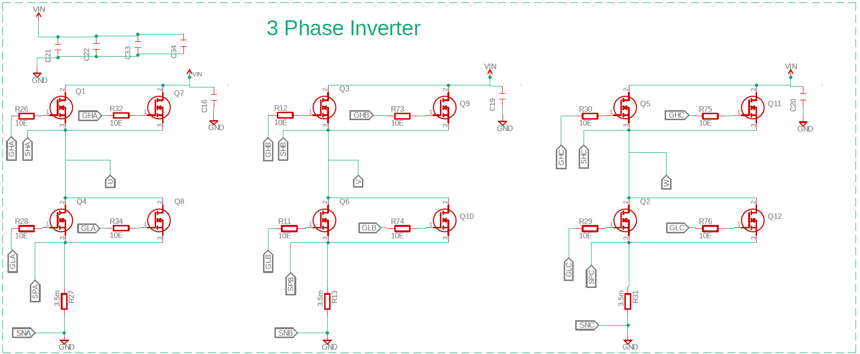

    I do not see your schematic for the 1/2-H bridges, is it something you can share? Also can you share your MOSFET part number?

    MOSFET part no. CSD19535KCS 100 V N-Channel NexFET™ Power MOSFET and I am using 2 Mosfets in parallel to increase the current capacity.

    Here is the schematics which you asked for.
