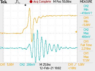

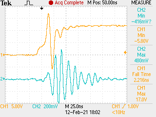

  • Hi Matt,
    After probing INLx, INHx and various points finally I could find a sharp overshoot and undershoot only on GLA and GHA pins consistently while I change the PWM mode from 6x to 1x PWM, all other pins like GHB GLB GHC and GLC are fine
    Register settings sequence as below
    Drive all input pins to low (INHx and INLx)
    1. Enable high
    delay(20ms)
    2. Set drive strength for HS as P_HS = 50mA N_HS = 300ma
    3. Set drive strength for LS as P_LS = 50mA N_LS = 300ma
    4. Change 6x PWM to 1x PWM ----> spikes are seen only after this independent of drive strength
    Did not release brake yet and HALL inputs are also pulled low
    Snapshot of GLA (yellow) and BRK (INLC) (cyan)
    I guess when the overshoot at break pin crosses its threshold I am seeing a jitter for a moment at this point
    Snapshot of GLA (yellow) and GHA (cyan)
    Why there is an overshoot only on GLA pin (I followed the same schematic used in DRV8353RS evaluation board except no gate to source capacitance)
    thanks, Chandra..
  • Hi Chandra,
    Your high-side gate is staying OFF, and your low-side is turning ON. I assume this is brake mode entry and all three phases have the low-side ON after switching to 1x PWM mode.
    You may want to try setting the COAST bit over SPI before you switch PWM modes (address 2x bit 2). This would make sure the motor does not immediately go to BRAKE state when you switch PWM modes - instead it is in COAST. You can clear the COAST bit after switching PWM modes.
    What MOSFETs are you using? The low-side gate GLA is showing around -5V negative spikes, which is pretty close to the abs max rating. Your high-side gate is showing almost -10V (close to abs max). This may indicate that your IDRIVE setting is too high. Given that you appear to switch in <25ns, this would also indicate that the 50mA IDRIVE source and 300mA sink setting you have chosen are  too high. ([FAQ] Selecting the Best IDRIVE setting and Why this is Essential)
    Matt
  • Hi Matt,
    Ans: 50mA is the lowest possible setting in DRV chip but still the spike could overshoot in <25ns. If IDRIVE is more then I wonder why other GLx pins does not have this behavior as they also share the same IDRIVE setting. All the mosfets are same csd19532q5b as used in evaluation board.
    Also after recovery from this spike I could run the motor with GLx rise time of ~400ns, it is this GLA only at the time of PWM mode change it drives so fast
    thanks, Chandra..

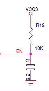

    After a lot of debug I found the issue for the sharp spike at power ON,
    In my design DRV's Enable, Direction and HALL sensor input masking pins are connected via i2c IO expander.
    Its reset pin is connected to resistor and capacitor as below [logic 0 is under reset and logic 1 is out of reset]
    At power ON this capacitor at reset pin takes few micro seconds to charge up to 3.3v, but while the voltage was ramping up half way I started initializing the IO expander and Enabled the DRV chip, at this time the HALL sensor mask was not yet latched up making all three HALL sensor inputs high which drives the MOSFETs to align state with default highest IDRIVE setting. This caused the sharp overshoot
    My suggestion would be that in future DRV chips please keep its IDRIVE default settings to lowest possible at POR, this will help us experimenting with DRV chips safely
    Thanks a lot for all your suggestions, now I am setting the BRAKE bit first and only then changing the PWM mode
    regards, Chandra..
