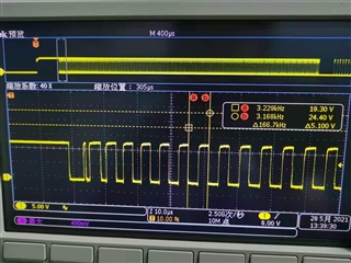

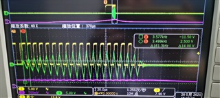

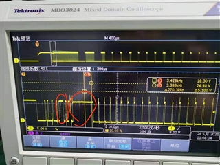

My customer used UCC256403 for a 54V/150W with 200kHz switch frequency, but the MOSFET will be shoot-through during the soft start,
The waveform as the below, ch1: gate, CH3: SS, CH4: ISNS

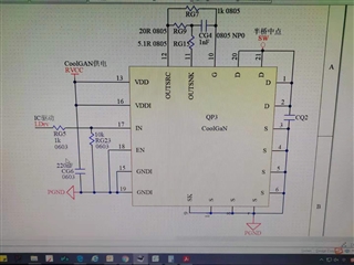

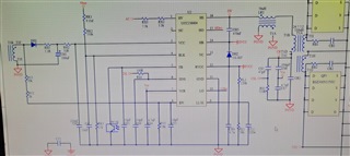

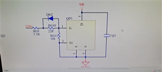

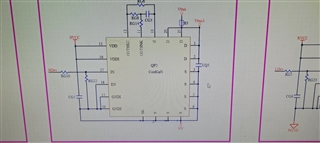

The schematic is the below, the RS5 used 470R now, L=510uH, turn raio=24:7, Cr=33n, Lr=70uH.
Will adjusting the capacitance of LL/SS help?
