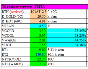

BQ25890: charging stuck while temperature range change
Part Number: BQ25890
 last time, I asked if I could set charging temp from 0-45. (CS0507272)
I get a spreadsheet could calculate RT1 & RT2.
So I set R_COLD (0C) to 27.28K and R_HOT (60C) to 4.91(original 45C resistor value)
and RT1, RT2 will be 9.25K and 352K.
but charge stuck while my battery temp pin resistor at around 7.x K. and i measure TS pin voltage is around 2V
According to resistor maps, it should only at around 32C
according to sheet, charging  should be stop below 1.5V
Do you have any idea what's wrong?
