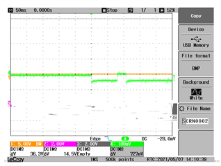

    Here are the plots I captured:
    1. Customer Complaint Controller with no alteration to the PCBA ( Regulator in place)
    The time between Power_Good and Charge_Indicator going low is approx 2ms.
    As you can see from the plot, the battery current goes back to zero,  before charge indicator goes low. The time interval between Power_good and battery current going to 0mA, is approx 1.6mS and it stays 0mA for about 0.4mS. The battery current is approx. 290mA.

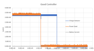

    2. Controller with no alteration to the PCBA and no customer complaint (Good Controller)
    As seen in this image, the current stays at 290mA after Power_Good goes low and it doesn't change.

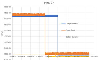

    3. The Customer Complaint Controller used in Point 1 with the regulator removed.
    The regulator was removed and the battery current is the same as in Point 1. We could not capture Power good or charge indicator in this plot due to the regulator being removed and disconnecting the power to our controller.

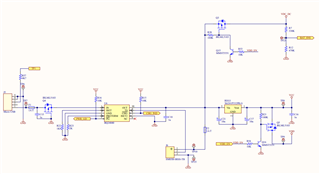

    I'm not able to access dropbox at work, can you attach the schematics here.
    Nick
  • HI Nick,
    Here is the schematic.
    Thanks Aileen
  • Hello Aileen,
    Recommend adding a 1uF input cap on the IN pin, C15 being placed before the FET may be causing some stability issues.
    The flickering you are seeing on startup could also be part of the battery detect routine. This is done by charging battery for 25ms followed  by sinking current for another 25ms, you can read more in section 8.4.12 of d/s.
    What is the voltage on TS pin during these tests?
