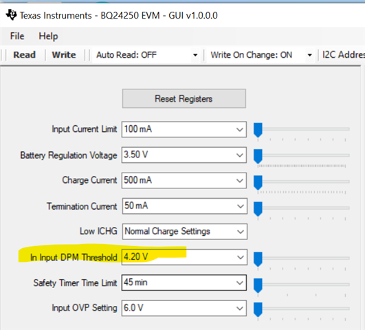

Hi Team,
The customer is asking that is there any concern to set the VDPM to 4.2V as the minimum value of the GUI?
However, the minimum operating range is 4.35V in the DS, please kindly help to advise. Thank you.

Hi Mike,
The datasheet minimum of 4.35V is the minimum recommended operating voltage that we can warranty. While the charger's register may accept VDPM=4.2V, TI cannot warranty the other specifications, like charge termination with BATREG set to 4.2V.
