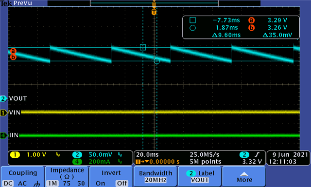

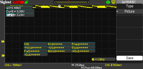

I have a problem with the development of our product, more precisely, with the operation of the AT42QT1012 touch chip.
We have our engineering design for a wearable device that has an AT42QT1012 Touch sensor chip. All-time MCU, LCD is disabled. The user can enable the device by the touch sensor. After enabling the system must shut down by itself within 15 minutes (+-10% according to datasheet).
The problem is that the current design doesn't work stably: the device is enabled by itself: when I leave the system on the table, the PCBA is connected to the battery, without any action, or put it on the charge, periodically, the touch turns on and off itself, without my participation.
In our previous PCB design, the touch worked perfect, but the DC / DC consumed a lot of current. We corrected the design of the DC / DC connection (like described in this post: https://e2e.ti.com/support/power-management/f/196/t/962067), added several resistors '0' so that it was possible to disconnect components from the PCB. Now DC / DC does not consume current, but the touch began to turn on / turn on itself. In the previous PCB design the DCDC out was like an attached image 2 all time.
But now, when the DCDC is in "Power Saving Mode", it works like an attached image 1.
When touch is "ON" and the system starts operation, the DCDC outputs exactly 3.3 volts DC, like an attached image 2.
This answer I have received from Microchip:
"If there is considerable noise in the power supply, such behavior can be observed. As the touch technology charges the sensor and measures the charge stored, any fluctuation in the voltage during this charging and measuring process can affect the signal values which can be similar to a touch (that changes capacitance).
Hence such false detects could occur."
How can I resolve this issue and equalize the voltage: remove the waves?

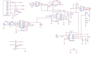

Attached my power management side schematic:

  • Hi Tao.
    I don't know when occurs false triggers, in a red part or in a blue part. I don't know what gives the noise in the red circle. According to the "IQ - What it is, what it isn’t, and how to use it" document, TPS63031 works in the Power Safe mode ( No-load operation).
    Can you give me any advice to understand how to remove the noise in Power Safe mode?

  • Hi  Evgeni,
            I am not sure  the high frequency noise in red part is caused by what, i am sorry i can not give your advice actually,  increase the output capacitor may help.
            But the low frequency ripple is caused by Power Safe Mode, it is decided by internal of TPS63031, is it possible make TPS63031 work in force PWM mode by connect SYNC pin to VINA in your application?
             Here is some other advice for you:
     >>>make sure  false detect is triggered by what? it is very important.
     >>>If the false detect is triggered by TPS63031, find out which part, high frequency noise or low frequency ripple?
     >>>If it is caused by low frequency ripple and FPWM mode is not allowed. It seems that you should try other solution.
     >>>power AT42QT1012 with DC source  to make sure the false detect is caused by TPS63031

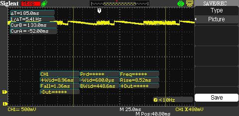

  • Hi Tao.
    I disconnected the touch from the DCDC and connected it directly to the vbat of the charging chip (it gives out the battery voltage all the time from 3.3 to 3.7 volts, depending on the battery charge level. After that, the touch stopped spontaneously turning on and off. This means that the saw that the DCDC makes in the energy-saving mode starts the touch.
    What is the solution to use DCDC in energy-saving mode, but without the saw?

    Attached picture from other PCBs (without red noise, but with the same reaction).

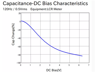

  • hi Evgeni,
         capacitance will change with DC bias as curve below, this curve is depend on the  material  of capacitor and temperature.
         BTW, increase the output capacitance is helpful to decrease the ripple voltage in my test.  hope it will solve the issue

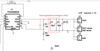

          I am sorry, I missed C19 C35 in your schematic and output capacitor is larger enough to decrease the  ripple voltage.
          It seems no method to  solve this problem based TPS63031 except FPWM mode is acceptable
          I tried another solution TPS63030, it has no different but output voltage be set by resister divider with TPS63031.
          test condition: 27pF capacitor in parallel with R1    total capacitance of C2 C3 change to 47uF.
          Schematic is attached as bellow:
        Test results: ripple of output voltage is 35mV,   a smaller one will get if you increase the capacitor in parallel with R1 or C2 C3.
                             loop is stable too in the test.
    so if it is possible change solution to TPS63030? the datasheet is attached

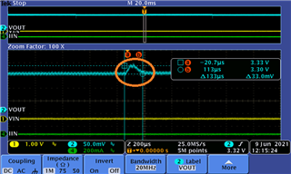

    3. What is a spike in the last picture? Is possible to remove it? What is the current TPS63030 consumption in the power save mode, less than 50 μA?
    Evgeni
  • HI Evgeni,
         1.C19 C35 C12 C13 are output capacitor in your schematic, may be you change C12 C13 to 22uF.
         2.connect PS pin to VINA pin, Then TPS63031 will work in FPWM mode
         3.Spike in the last picture is caused by load transient, it will not exist in steady state.  The current TPS63030 consumption is same as

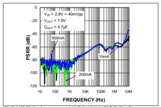

  • HI Evgeni,
         Unfortunately,  Ripple blocker have no help to low frequency ripple, as showed in the PSRR curve.
         If adding a Ripple blocker is acceptable, do we have a chance to change solution with TPS63030?

  • HI Evgeni,
          With smaller package and larger capacitance, effective capacitance may decrease for  rated voltage reduced or worse material(such as X7R change to X5R). please be careful.
          such as 94325/45/55, PSRR curve is attached below.
         you can also find many similar chips in TI.com, such as TLV73333P.
         Notice: consumption will higher with added LDO for efficiency decrease

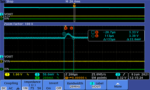

            By the way, waveform attached in you latest reply is a transient test to make sure loop is stable. please take follows as reference.
    Tao
  • Hi Tao.
    Thanks for the link.
    Can you check on your development board, if there are spikes that we can see in the picture all time, or periodically, or sometimes?
    In addition, is possible to use PSpice for TI Simulator for these tries instead to try to replace capacitors in the Dev Board? www.ti.com/.../PSPICE-FOR-TI
  • Hi  Evgeni,
           you are welcome.
           Spikes only appear during transient load switching, output current change to 0.1A from 0.5A with 250mA/us. I want  to confirm that my changes will not affect the loop stability by this test. I'm sorry for confuses you with this unnecessary information.
           That is a good idea of PSPICE, But you may need some time to adapt to this software. Simulation and actual measurement results may have some slight differences due to parasitic parameters, but the overall trend is the same.

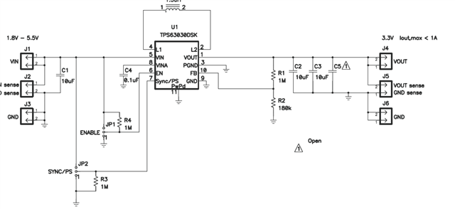

    3. Can you provide me with a schematic connection of DC-DC TPS63030 and your capacitors and resistors changes so that it can work in energy-saving mode, as in the last representation (but without spike):

  • Hi  Evgeni,
         Maybe  I didn’t explain clearly enough, i would like to explain for you again  as follows.
         1.This picture is taken in PWM mode with a transient to make sure loop is stable. it has nothing to do with PFM mode. As you know, loop test is meaningless in PFM mode for a bigger ripple is exist and loop is not same with PWM mode.
       2.This picture is taken in PFM mode, a low frequency ripple 35mV is exist in the test. I prefer to call high-frequency signals "spikes" while low-frequency signals "ripple". I am sorry it makes you confused
       3.Here is the schematic in the test . please notice the red part
       4.Yes, if tps63030 work in buck topology, for output current is same as average of inductor current, it may run in PFM mode, but ripple will much smaller. ripple is different with different output current.
           If work in boost/buck-boost topology. output current is smaller than average of inductor current.
           so I think it is ok with your application.

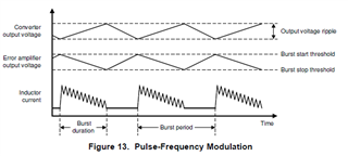

    Is it in Power-Save mode TPS63030 works in PWM mode or in PFM mode? What is PFM mode? I don't see any information in Datasheet about this.
    Can you provide 2 measurements with TPS63030, please:
    1. In Power-Save mode (without ripples and spikes). What is the consumed current?
    2. In Operation mode (without ripples and spikes).
    The ripple voltage on the power supply should be less than +/-25mV in both cases. Otherwise, this DC-DC is not suitable for our system.
    Evgeni
  • Hi  Evgeni,
        For part of our instrument was sent for calibration yesterday, there will be some delay for my test. I hope to give you a complete and detailed      test report before next Wednesday, is that ok?
        I think you can take follow picture as PFM mode, but it will be some different with TPS63030.

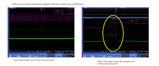

  • Hi Tao.
    Thanks for your measurements. What do both measurements mean? At what outlet are green and crimson colors measured?
    The system must work in the Power Save mode without ripples. What are these ripples?
    Is TPS63030 can work like in your picture but without spikes? Is PWM mode allow in the Power Save mode?
    Evgeni
  • Hi  Evgeni,
    green: inductor current    crimson: output voltage.   just zoom in from another. i want show you how PFM working
