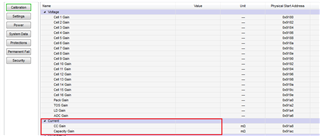

BQ76952: When the current sense resistance is 0.5 milliohms, bq76952 cannot enter sleep mode. What adjustments does FW need to do?
Part Number: BQ76952
TI experts,

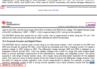

I read the chip specification of bq76952 which suggests that it can support below 1 milliohm.
At present, after changing the current sense resistance to 1 milliohm, bq76952 can enter sleep mode, but the SRN and SRP voltages will exceed 200mV when short-circuited.
