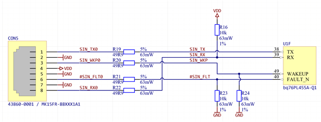

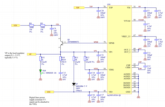

I have designed a custom board based on the bq76PL455A-Q1 device and the bq76PL455EVM evaluation module. I am now trying only with one board to communicate it with the host PC over an FTDI USB to UART adapter and the TI DEMO GUI app. The communication scheme of the "master" device looks the following:
Currently only the TX and RX pins are connected to the adapter. The power management part looks the following:
Each bq76PL455A-Q1 board is a "slave" by default. If the USB adapter is connected to the master connector, the 5V power logic is applied from him to the VIO port, which overlaps the on board 5.3 V from the LDO (the D7 voltage drop is ~0.5 V so no conflict between the on board LDO and ext. power supply).

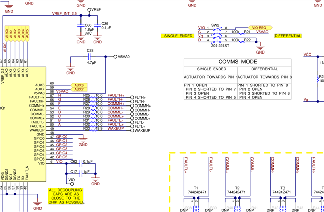

So to summarize, it seems that some internal states of the bq76PL455A-Q1 are changing, but I cannot communicate properly with the device. What am I doing wrong in here? Am I missing anything in the hardware? I have studied the EVM board design again and the only real difference in HW for the master device I could spot is that the COMML+/ COMML- lines are pulled up/ down with 100k resistors- but can this be the case? Also instead of completely disconnecting the regulator output, I have the D7 diode, but in this case it does not conduct, as the 0.5 V voltage drop is not reached (regulator output is 5.3 V, the applied VIO externally voltage is 5 V).

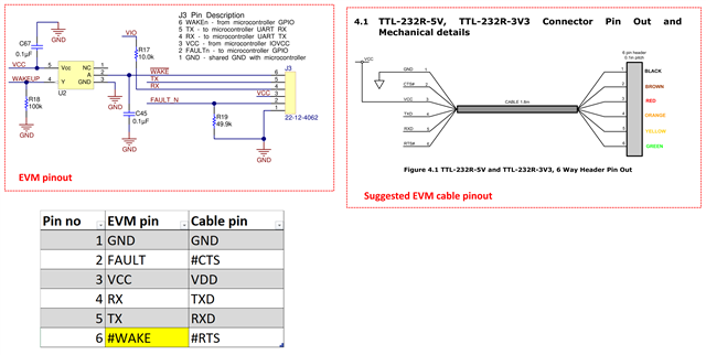

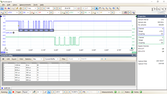

    Thank you for the answer. I have read the posts from the topic you have linked. It seems that the UART #CTS and #RTS lines are somewhat used in a "hacky" way with the EVM. I do not have the exact cable specified in the EVM DS, but I do have a legitimate FT232 based USB adapter that has RTS and CTS exposed as well. I haven't installed any special drivers though.

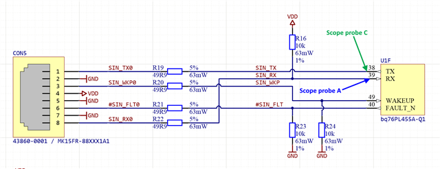

    Before I dwell further into the details, let me star of by saying that my adapter is sending data when the GUI program starts and that can be observed on the scope:

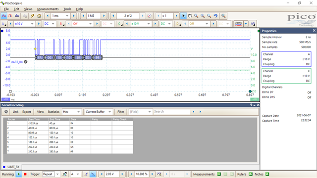

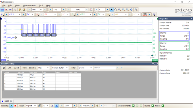

    The data is visible on the RX line (have set the serial parser to 250k, 8 bits, 1 stop bit, no parity).
    First program open:
    Second program open:
    I assume the transmitted data by the program is correct, but there is no response from the bq chip.
    In my config, only the VDD, GND TX and RX lines are connected. The WAKEUP and #FAULT are floating. If we examine the information gathered about the connections, it could be setup together like this:

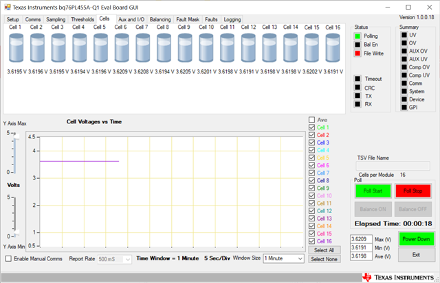

    So it seems that the #fault drives the #CTS pin, while the #RTS signal (on the host side) drives the WAKE pin, which's logic is flipped on the EVM PCB. On my HW, the WAKE input is not flipped, so I have changed the logic of the RTS pin in the FT_PROG (its now low by default). This allowed me to communicate with the device from the host PC!

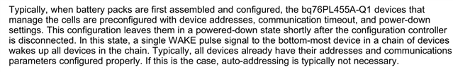

  • Hi Lukasz,
    This part from datasheet explains WAKEUP 0 - 1- 0 transition and timing, and delay before auto addressing commands after this. The example code also has this written out.
    Taylor
  • I can work with that, thanks!
