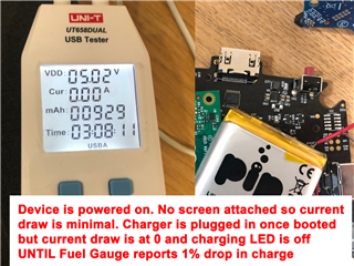

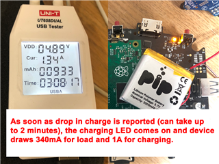

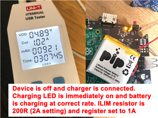

We are finding an unusual delay in detecting charging status using the BQ24295.
When the device is powered off (there is no load), the charge status detection works very well and pretty much starts charging the battery instantly as soon as a charging cable is plugged in.
When the device is powered on however, there is a delay in detecting the charger connection. The interrupt signal on the charge_int pin can have a detection delay of between 5 seconds, to over 60 seconds. Please see circuit below. Is there a registry setting to fix this issue?

    If you have set the input current limit too an amount that can only supply your system power, then it may not charge your battery. If you log the registers during the test we can see exactly what the charger is doing, check and make sure the INT you are seeing is the one you expect, not a different interrupt.

  • Hi Wyatt,
    I did some further testing and have attached the log file and register settings below.
    We have set the ATTiny to send a status report from the Fuel Gauge whenever the battery charge changes by 1%.
    When the cable is disconnected, it should report:
    "Sys MGR: Event: CHARGER_TRIG  State: IDLE
    Charge Status: No External Power"
    When the cable is plugged in, it should report:
    Charge Status: Not Charging"
    This is immediately followed by:
    Charge Status: Fast Charge"
    These are all reported correctly when the device is powered off and there is no load. When powered on and the cable is disconnected, it correctly reports the following:
    Charge Status: No External Power"When the cable is plugged in with the load present, it should report the Charge Status as "Not Charging", followed immediately by "Fast Charge", however the "Not Charging" status is never displayed and nothing happens until the battery charge drops by 1%, at which point the Charge Status is reported as "Fast Charge" and charging begins. Please see logs attached for device powered on and powered off. To summarise, the insertion of the cable is not detected when the device is powered on.

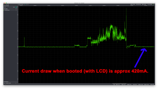

    With regards to the max charge settings, could you please give a bit more guidance? At the moment, both are set to 1A. Based on your info above, one should be set higher than the other if I understand correctly... but not sure which way around this should be. If the resistor is set to 1A (200R) but the register is set to 2A, will it charge at 1A when powered off, but draw up to 2A when powered on? Or should the resistor be set to 2A and the register too 1A. I understand the charger will charge at the lowest of the two, but not sure which way around it should be.

    I have probed the lines and output is shown below:
    - When the power is off and the cable is inserted, the charge_int line on the BQ24295 triggers the I2C and starts charging  without any delay (confirmed by start of current draw). There is no activity on the Fuel Gauge GPOUT line.
    - When the power is off and cable is removed, same pattern as above
    - When the power is on and the cable is inserted, there is a long delay (couple of minutes sometimes) until the fuel gauge sends sends a trigger on GPOUT line to ATTINY to indicate a 1% decrease in charge, which then triggers I2C, followed by charge_int line on BQ24295.
    Does this definitely point to a FW issue? or is it the settings or electrical? Thanks in advance.
    Yellow = CHARGE_INT (BQ24295)
    PURPLE = GPOUT (FG)
    GREEN = SCL (ATTiny)
    BLUE = SDA (ATTiny)

  • Hi Wyatt,
    Thanks for getting back to me. With regards to the input current limit... is it a max charging rate, or input current limit? If I set ILIM resistor to 2A and register to 1A and the load draws 1A, will the battery charge at 1A at all times (with or without load)? That's ultimately what my question is.
    With regards to the register outputs, we are a small startup and don't have the need or funds to get the USB2ANY interface. It is something we will only use once, so don't wish to purchase it. I have translated the register readings in the attached spreadsheet. Will these do? We are just wanting to know why the insertion of the charging cable is not detected when the system is powered on. The charging is only enabled when the fuel gauge detects a drop of 1% and the charging sequence and current draw only begins at that point. That can be up to 2 minutes plus... until the battery charge has dropped by 1%.
    Please see attached log details - I have a tab at the bottom showing logs with and without load. A quick reply would be much appreciated as we have units ready to ship but can't ship with this issue.
    Sukhvir

  • Hello Sukhvir,
    I reviewed the excel you shared, but it looks like the during the period the load is applied and the adaptor is plugged in without charging, you say there's nothing displayed? What does this mean? That would be the most important time to read the registers to see what mode it is in. Is the device not responding to the address?
    I'm not sure how the gauge reporting 1% drop in SOC is tied to the charger operation for your system. If you are using it to control charge it may be better to tie the condition to something else that would immediately start the charge.

  • Hi Wyatt. I'll see if i can get more readings for you from the moment it is plugged in. The 1% drop in charge initiating the charging is not a condition we set; rather it seems to be a trigger but we are not sure why that is the trigger for this.
    When I said nothing is displayed when the charger is plugged in under load, I mean there is absolutely no activity anywhere on the charging circuitry when the charger is plugged in. Everything seems to happen automatically when the 1% drop in SOC kicks in. This seems to be because the I2C lines are polled when the SOC changes.
    I tried to get further log readings for you by manually pulling the charge_int line low before and immediately after connecting the charger. The settings just after insertion are below (only the ones that change are listed):
