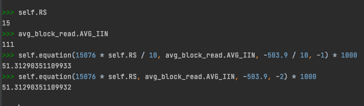

  • Hi Rakesh,
    When CL=VDD; m value = 15076 × RS = 226140 for Rs = 15m Ohm the Power and current measurement are wrong by factor 2.
    When CL=GND; m value = 7645 × RS = 114675 for Rs = 15m Ohm the Power and current measurement are correct. (But my hardware PIN CL is at VCC)
    So the table coefficients are swapped. Can you reproduce it on your side too?

  • Hi Rakesh,
    so i am still facing the  issue.
    The current i am measuring is 17mA and 7.09mA is wrong.
    It doenst matter if i divide by than the result is the same too:
    If i increase the current, i am measuring 110 mA and this is what i am getting:
    If i look into the example "5-mΩ sense resistor is used, the correct coefficients for the READ_IIN command with CL = VDD would be m = 7553, b = –65, R = –1"
    m = 15076 * 5 /10= 7538 and it is not 7553
    b= -503.9/10 = -50.39 and it is not -65
    R =-1
    How can i corretly measure current? Or how do i normalize it corretly?

  • Hi Rakesh,
    found the issue CL is connected to VDD, on the sofware register we were writing it to be LOW so 50mV and ignore the PIN configuration.
    If our custom PCB is hot swapped and quickly the software didnt write the register and the IC was using CL PIN configuration at VDD.
    We fixed that and the formula in the datasheet works.
