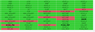

  • Hi Sean,
    The PCHG will turn on only a few seconds and turn off if the part goes to sleep with the default charge settings.  If there is no current it will go to sleep and if the FET settings are default the charge path is turned off in SLEEP.
    The config update mode will clear the sleep disable command, so the part will revert to sleep enable mode.  You can likely see the FET toggle in the registers pane of BQStudio. on:
    off:
    The part controls the charge path with the FET commands, but the FET used in the charge path is selected by the voltage.  If the voltage is above the Precharge Stop voltage the charge FET is used, if the voltage is below the Precharge Start voltage the precharge FET is used.
