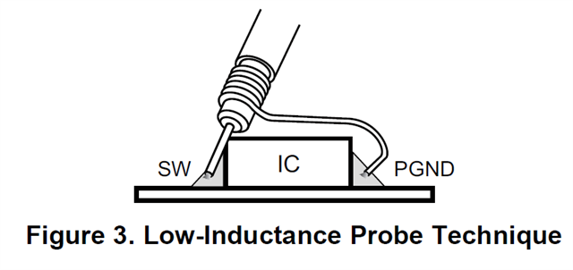

2. Besides, I found the trace between IC's GND and input cap's GND is connected by VIAs, the loop area is big, when IC is switching, the PH node will have big spike voltage which might cause overstress on IC and damage IC.
So could you measure the PH signal at max loading? I want to check the spike voltage on PH signal.

It looks there is big spike voltage on PH pin at light loading.
1. Did you use the small loop to test PH signal?
2. For the input voltage, is it well-regulated? what is the tolerance of input voltage?
I concern Vin has big tolerance and plus spike voltage which is larger than maximum rating voltage of TPS54335A, then IC would be damaged.
If you have re-design layout opportunity, suggest modify the layout according to the TPS54335A EVM reference design.

Hi, Zhang
1. Yes, see the small loop measurement in the below.
And double check the spike voltage on PH voltage.
2. It looks the Vin is well-regulated.
However, still suggest modify the layout according to the EVM reference design.

I follow the picture to measure the ph pin.Please help me to re-check the waveforms.
Hi, Zhang
It looks the spike voltage on SW is not big.
Right now, I also have no idea about why IC is damaged.
