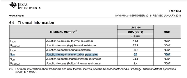

The customer are evaluating thermal performance and wander if we could take ΨJT to do the parameter when there is no heat sink on top of LM5164.
Could you help to confirm this?

Hello Denny,
This is a duplicate post. See answer here: link.
"Yes; ѰJT should not be used when application of a heat sink is intended."
