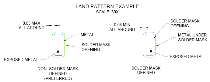

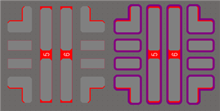

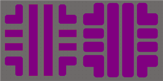

It doesn't look like the Altium UltraLibrarian footprint for the TPS25947 has been fixed.  The datasheet shows the correct solder mask information.  In the Altium UltraLibrarian footprint, the solder mask is exactly the same size as the copper pads.  Here are some screenshots:
The UltraLibrarian footprint is on the left, and what it should look like is on the right.
Copper pads, with solder mask in the background:
Solder mask only:

    Altium footprint is following solder mask defined pattern so solder mask openings is not beyond the metal. The datasheet shows both options solder mask defined and non solder mask defined. Is non solder mask defined better?
    Kunal Goel
  • Hi Kunal,
    The footprint is not following either option, though technically you could say it is following non-solder mask defined per the datasheet.  I say that because the datasheet says "0.05 MAX ALL AROUND", so technically 0.00 meets the requirement (but is not a good value to use).
    Per the datasheet, Solder Mask Defined requires an overlap of at least 0.05, but the solder mask and copper in the UltraLibrarian footprint are exactly the same size.
    You should not have a solder mask that is exactly the same size as the copper pad.  It is virtually impossible to align the solder mask with the copper perfectly.  You will have solder mask partially on the pad.  I've been told this tiny amount has a tendency to flake, and you don't want pieces of solder mask ending up elsewhere in another solder joint.  Non-solder mask defined is preferred because the solder has more surface area to attach to, providing a more secure attachment.  This is especially true because the attachment is in multiple dimensions because it attaches to the sides of the pad as well as the top.
    The reason there is a MAX spec for Non-Solder Mask Defined is because you need a minimum amount of solder mask web between the pads.  Otherwise the web can break and flake off and become a problem elsewhere.
